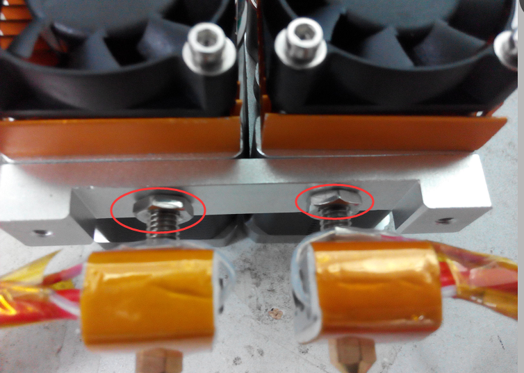

Hmmmmm, it's hard to describe. At present you can calibrate the nozzle height by rotating these 2 screws:

I'm having the same issue. Its almost impossible to get both head level. The problem is that the extruder part is also screw type and every time we adjust the feed screw the heating block is facing another direction although the head is aligned. So to get the heating block to where we want is almost impossible without causing the head out of alignment again.
