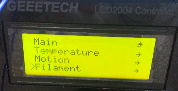

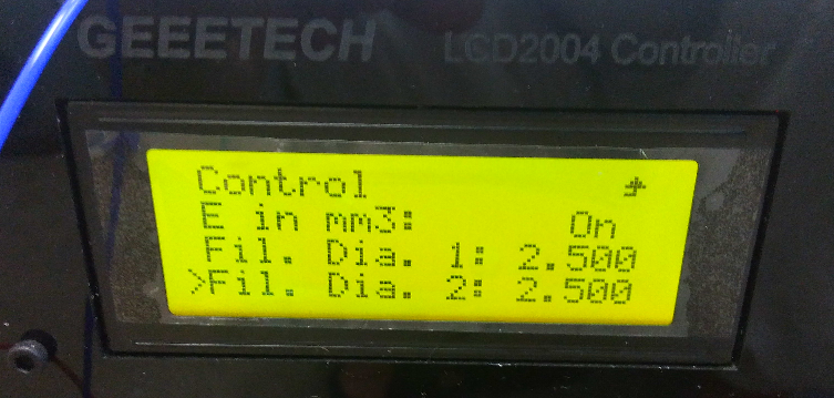

3. and, look at this attached photo please. how can I set Filament dia. under 2.500
thanks
please send me again Firmware & source file for GT2560 (white color control board)
2. GT2560 White Control board pin assign compatible to which control board ? Ramps or Pololu or Sanguinolu ?
thanks
- Filament Dia. setting menu on Control Menu
- 2.png (346.43 KiB) Viewed 18848 times
- Filament Dia. minimum value is 2.500
- 1.png (462.61 KiB) Viewed 18848 times

1. I sent the firmware to tutor4com@nate.com on Monday with an attachment. Just now I sent the firmware to both of your emails again.
2. GT2560=Ramps1.4+Mega2560, but the driver is as same as Sanguinololu.
3. In our setting, the status of "E in mm3" is off.

I also have a problem with the Filament dia settings. I also have the GT2560 white board.
When I restore from failesafe the settings for the Filament dia are off, everything works fine. but after rest, the settings come back and instead of the 2.500 I have different charters, not numbers. im unable to turn it off, and it stays on "on". I have to reload the failesafe settings again because loading setting settings that I save after calibration to the EE2 dosnt change the Filament dia to off.
Any idea what can cause this?
Thanks.
Thanks.

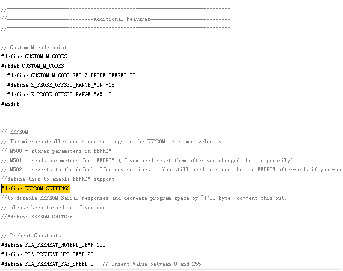

hi,if you want to store the modifid parameters ,please turn on LCD,select "control"---"store memory".
if you could not find the option,maybe it's hidden.you must release it by changing firmware.look at the following prongram.
//#define EEPROM_SETTINGS ...............if there is a "//"before "#define EEPROM_SETTINGS ",the option will be hidden.
- QQ图片20150714152252.png (11.6 KiB) Viewed 18701 times

Hi.
I already tried to save the parameters and reload them when the issue occurs, it didnt help.
I have uploaded the latest firmware for the 2560 board and its working fine now.
Thanks.
