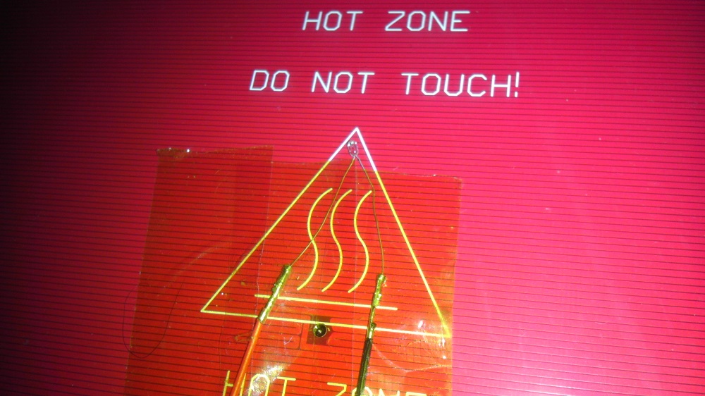

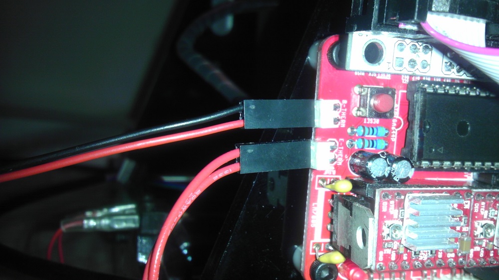

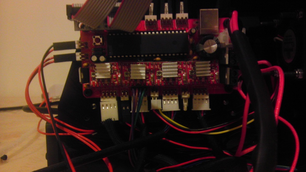

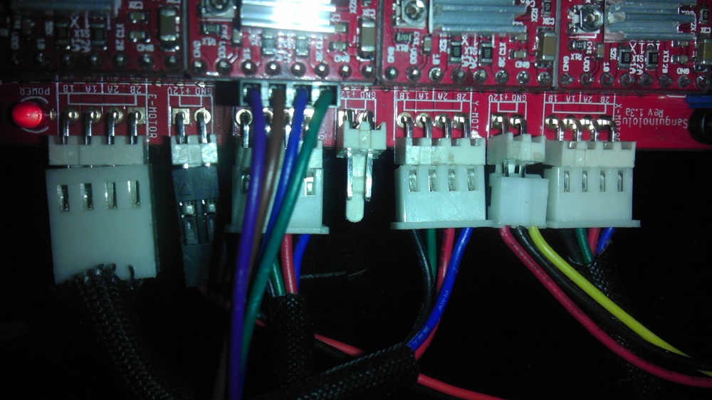

i have included pictures for the sanguinololu board as connected to it the fan and the thermistors, i also included pics for the bed thermistor and the screen error and manual control which is dead, i cant really connect to the printer although i am pressing auto home , the extruder has never moved since i got it, i hope i am using the prusa printer right because it is my first week with it and it hasnt printed a thing yet

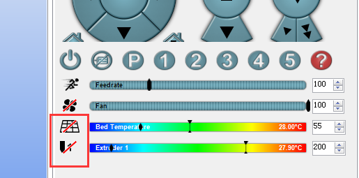

The extruder motor can not move unless the temperature is more than 180 degrees. You can heat up the extruder and hot bed by clicking these two icons:

As you can see on the mainboard, there are 3 slots for connecting fans, please use a multimeter to test their output voltage respectively. If they are all 12V, we can conclude that the fan is dead, otherwise there is something wrong with the mainboard.
As the thermistor, I don't think it is abnormal, because it is normal before the temperature reaches 35 degrees. On the contrary, I think it is firmware issue. Let's check if it is firmware issue. I've sent the firmware to your register email, please check.
Re: multiple Problems
First, The output of the 3 fan slots is the same (3v) which i think it the fan problem,also i have measured the voltage on the bed thermistor, it is about 4.41 v....which means it is working fine...i think it came to the board and the firmware....waiting for your firmware email....hope it changes something
