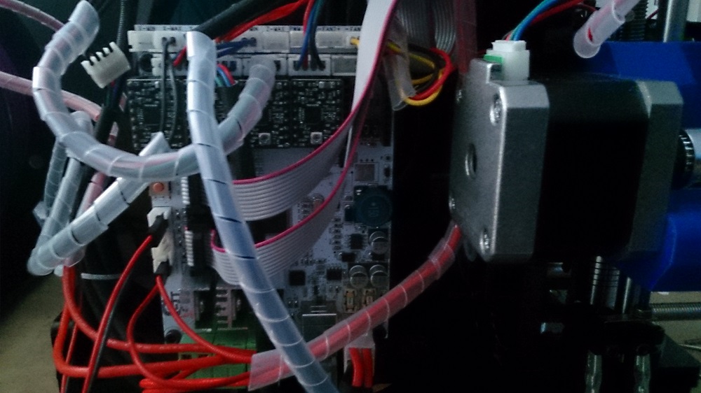

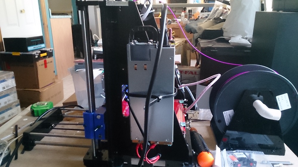

received it 5 days ago, many bugs on pdf file (bad plug locations) and at the first power up the power supply fuse burn out so replace it and unplug the board cable from de power supply then 2 other fuses burn out so I replace the power supply with an old one I had here now it's working with many other bugs opérations and the extruder still not working stepper is ok I test it on x drive and the temp is ok do you have the last firmware for the GT-2560 board and do you have an idea for the extruder why it's not working.....?????

- connection on the board
- GT2560.JPG (155.78 KiB) Viewed 12776 times

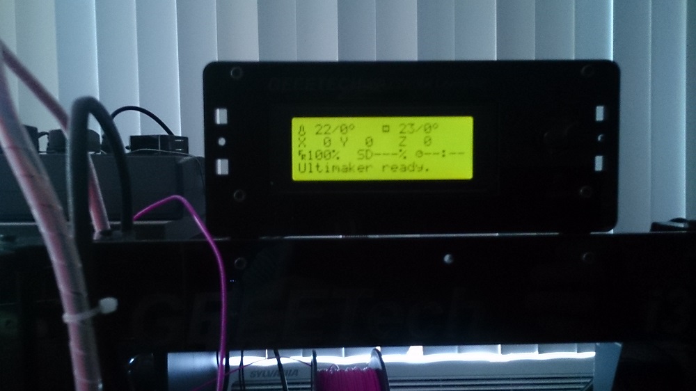

- ultimaker.JPG (114.23 KiB) Viewed 12776 times
- the firmware on the I3 Pro B
- power supply.JPG (192.12 KiB) Viewed 12776 times

3. The original PSU is defective had to replace it with an old one I had here and it's working
