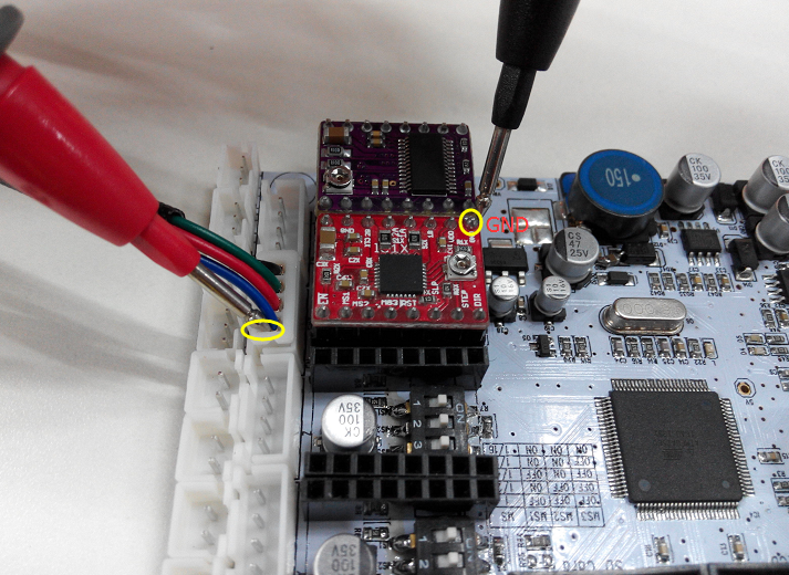

1. Can you get the AC voltage between GND and any pin of extruder 0 slot when you are moving extruder?

Have you tested the output voltage of extruder motor slot? Can you get a changing AC voltage when you are moving the extruder (actually it's not moving, I mean when you give the command)?

I did the check with extruder temp to 200C and i didnt notice any change in AC Volt, when i was giving the command via the display to the extruder motor. The indication remains the same in all pins, Blue-Red-Green-Black. After that, I swaped the A4988 Board from X Axis to the extruder. I did the same check and again, i didnt notice any change in my multimeter. The same results.
Re: Extruder Stepper motor doesnt work.
I forgot to post the measurement in my previous message, It was 0 Volt AC Between GND and Red-Blue-Green and Black pins.
