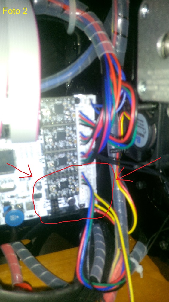

The 06/18/2015 I received the printer GEEETECH I3, with card "GT2560"
Mounted but the extruder is not turning.
I include photos mounting tab to see if the wiring is correct. I tried to control it manually with the LCD menu, but does not turn.
In both the two connections for any extruders the engine runs.
I invert the motor "X-axis" with the engine of the extruder and manually commanding the extruder motor turns, while the "X" axis is not moving.
I reversed cards "A4988" and in any case the extruder is not working, while the other three axes always work properly.
I checked all the tensions between GND and the blue wire of the engine in all 5 positions possible, and is 12 Volt
At this point it could be a hardware problem card "GT2560" or a software or firmware problem?
I have to make me replace the card since the printer is new? Or I can do other tests?
Thanks for the help I can give.
ps: sorry English translator

Hi, the wiring is correct.
Is your printer I3 pro B? We've sent you the firmware for I3 pro B to your email, you can refer to this page to upload it:
http://www.geeetech.com/forum/viewtopic ... 20&t=16433
Oh, something have to remind you, you need to raise the temperature to more than 180 degrees to move the extruder.

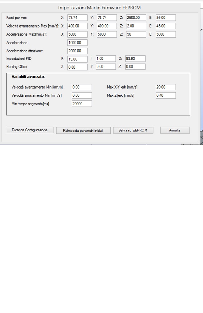

Re: EXTRUDER NOT WORK
Buon Giorno
Ho caricato il firmware che mi avete inviato,
ma il problema persiste. l'estrusore non gira!
Parametri di stampa
Good Day
I downloaded the firmware that you sent me ,
but the problem persists . the extruder does not run !
Printing parameters
