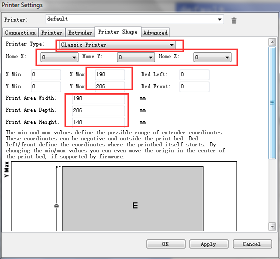

Hello! Sorry for disturbing you, I found a very strange error that I can't understand.
I did some successful print with my Prusa I3, and I tryed to change some settings to improve quality. Yesterday I got the first occurrence of this problem:
In Slic3r, I put the model in the centre. When I start the print, the prusa start printing near the top border.
I don't recall changing something relative to this, all the axis move without problem, and the endpoints works flawlessly.
Do you have any idea where I could start looking for fixing it?
Thanks a lot for your work, I really appreciate it!

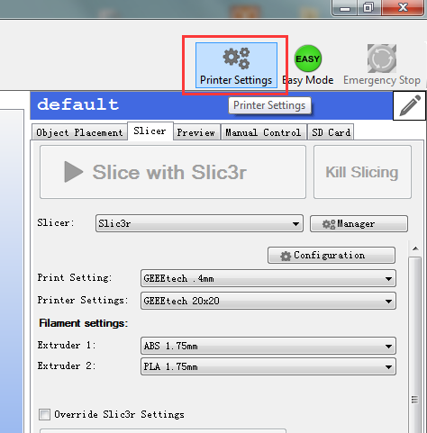

Access "Printer settings" to change some parameters:
printer setting1.png (31.25 KiB) Viewed 6536 times
printer setting2.png (25.19 KiB) Viewed 6536 times

Thanks a lot! I'll take a look this evening ;)

It works! Thank you very much! 8-)
