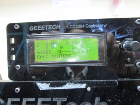

LCD Display
LCD Display

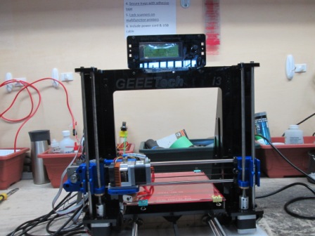

Assembled Printer
Assembled Printer
I have now completed the assembly of the Geeetech I3 Pro B.

program. I am only able to make the motors move to the home position from the LCD display (Auto home).
I am not able to control the motors manually from the manual control in the program.
The display shows extruder at 0 degree, the HOT BED at 24 degrees. Err: MINTEMP. FR: 100%.
Please can you explain what are the issues at present and what needs to be done to resolve these issues.

When LCD displays "0/0", the corresponding thermistor is not well connected to mainboard, or it is plug to the wrong slot.
"Err: min temp" means extruder thermistor is not well connected.
"Err: min bed temp" means hot bed thermistor is not well connected.
You must let all the axes auto home if you want to control x, y, z separately.

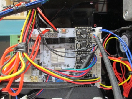

Could you please take a picture of your mainboard with wiring, let me check for you.

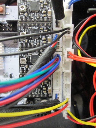

Thanks for the response, forwarding the wiring pictures. I have removed
the LCD and SD card cable for better view.
Vijay
Motors & endstop wiring

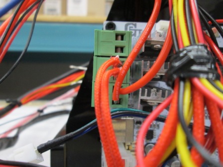

Extruder, Hotbed thermistor wiring
Extruder, Hotbed Thermistor wiring.JPG (53.34 KiB) Viewed 7965 times
Extruder & hotbed wiring
Extruder & Hotbed wiring.JPG (58.38 KiB) Viewed 7965 times
Main Board wiring
Main Board wiring
Main Board Wiring.JPG (76.46 KiB) Viewed 7965 times

hi,according to your describe, the motor do not turn because it could not read the temperature correctly.please replug the thermistor wire and tighten it.
