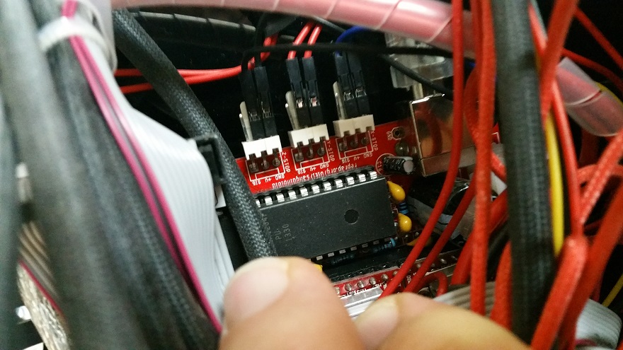

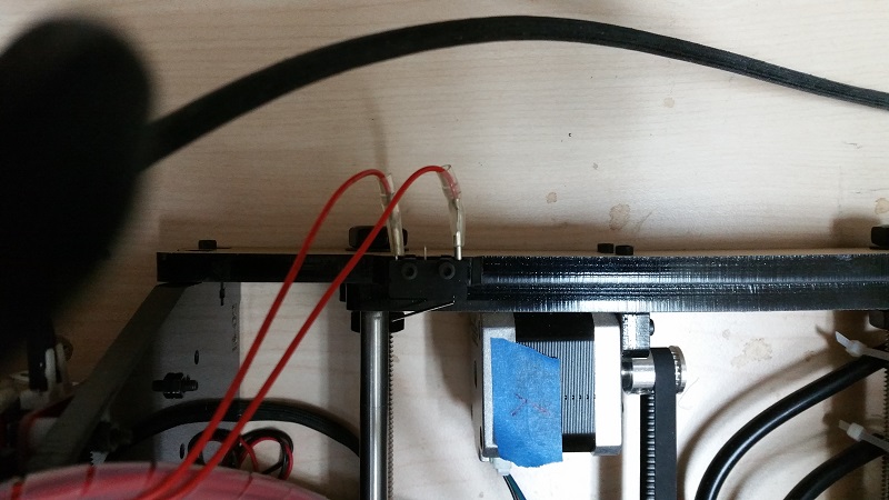

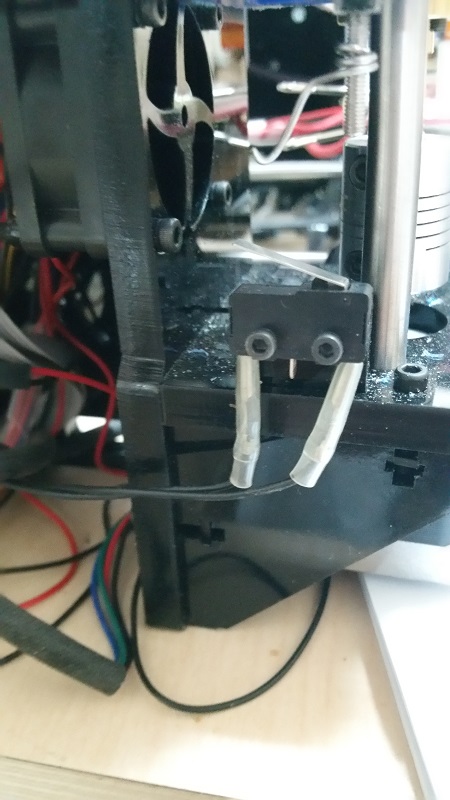

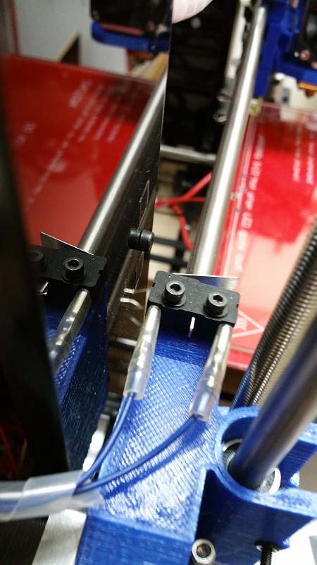

These are the pictures of the end stops and the connections on the Sanguinololu board

hi,you connect the endstop wire to wrong slot,the wire should connect to "sig" and "-".please see the picture where i mark a red circle.
