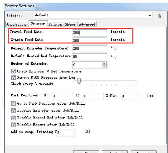

hi,please reduce the travel feed rate.more information,please refer to following link.
http://www.geeetech.com/wiki/index.php/ ... _preparing

Thanks Eric, problem solved
