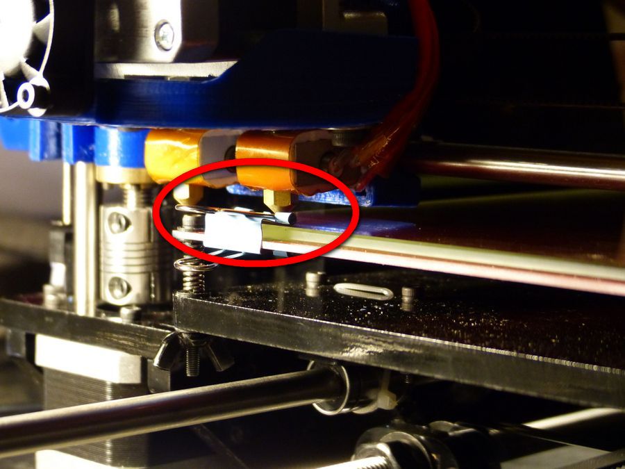

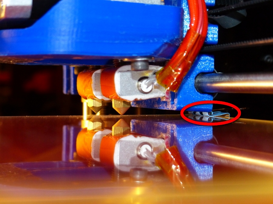

Almost finishing to assembly the printer. I have some details:
1) There is an interference for the free movement of the nozzles with the clips installed to hold the cristal in the front and in the back, so this reduce the printing space. Mostly the clips installed in the back since it reduce about 5cm of the print area ->
2) Is there any instruction of how to level the nozzles? Is it necessary to dissasembly the printer head?

As problem 1and 2,you can adjust the nut to get the height you want ,and your problem will be solved!
