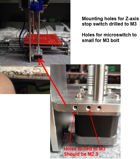

I recently purchased one of your Prusa I3 Aluminium kits and I have encountered a few problems that have occurred during manufacture"
  • 1 Cut out for LCD display backwards:
    2 Mounting holes for Y-Stop and Z-Stop switchs drilled to M3 instead of M2.5
Any Suggestions? - Thanks
Mounting holes for Z stop switch drilled to M3.
Z Stop Switch.jpg (104.98 KiB) Viewed 6976 times
Mounting holes for Y stop switch drilled to M3. I might be able to drill and tap new M2.5 holes in a new location
Y Stop Switch.jpg (117.63 KiB) Viewed 6976 times

The M3 screws don't fit through holes in the microswitch

Oh, I see,you're right. You can contact the customer service to have a new one, or print a bracket FOR the LCD designed by yourslef, I think it's great.
And "The M3 screws don't fit through holes in the microswitch", I asked about it, you can work this out with the M3 screws, just use a little force to screw it in, don't worry too much about the swithc, like this:
