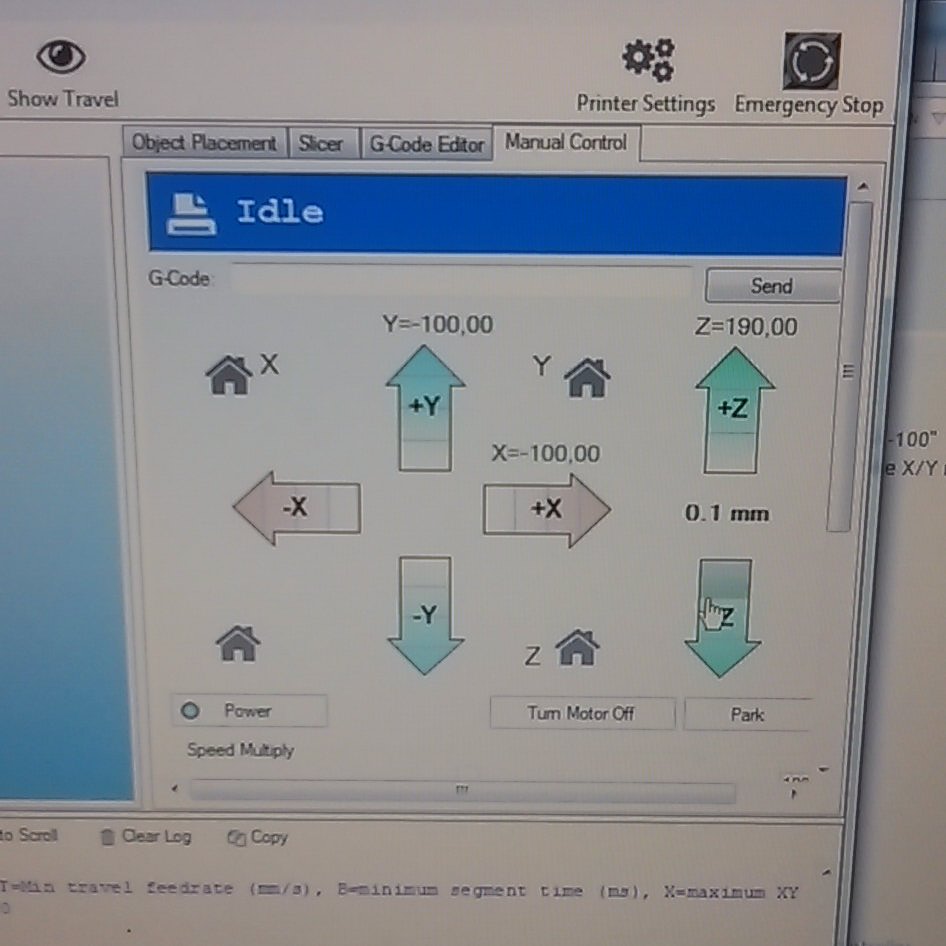

The endstops are mechanically well fastened, if that`s what you are asking about:) And they are working well showing "open"-value on all max endstops when they are open, and "open" on z_min when triggered.
LCD "problem" is now solved.....I had to #define ULTIMAKERCONTROLLER....of course:P
But my main issue is now that all axes are homing perfectly, yet when i try to lower all axes towards the bed i can only go half way down on x and y axis with a value of -100(they won`t go further down) on both axes in repetier. So i cannot find the values to define the initial an final z axis height. Both x and y axis has a homed value of "0" and will not go further down than "-100". Z axis has a value of 193 in homed position and when i press 1mm in manual mode on repetier it travels a lot more than 1mm on the z axis and it is not even close to zeroing out towards the bed.(think it has a bottom value of about 188 or so....)
This is my configuration_h file at the moment:

Re: problem with z-axis on delta mini g2
"only go half way down on x and y axis with a value of -100"
For delta G2, the radius is 100 and the zero is 0, so the X/Y max is 100, min is -100.

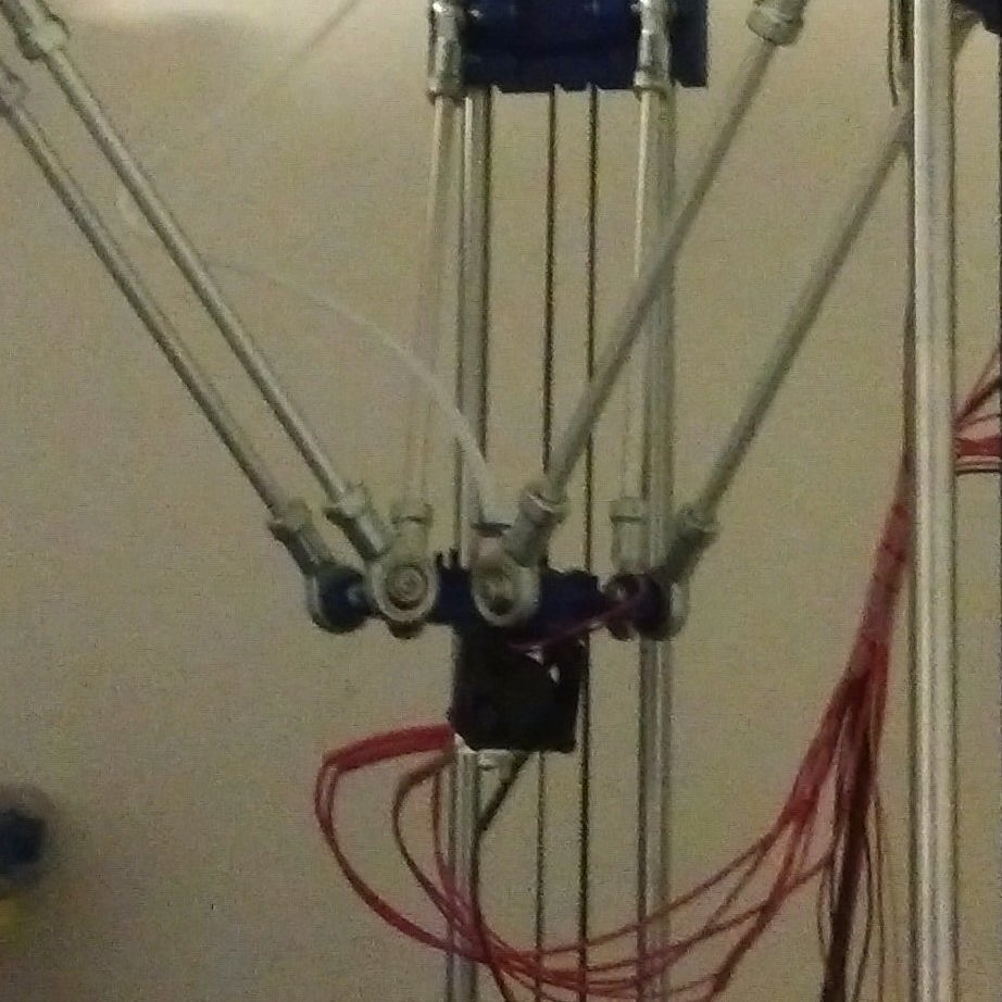

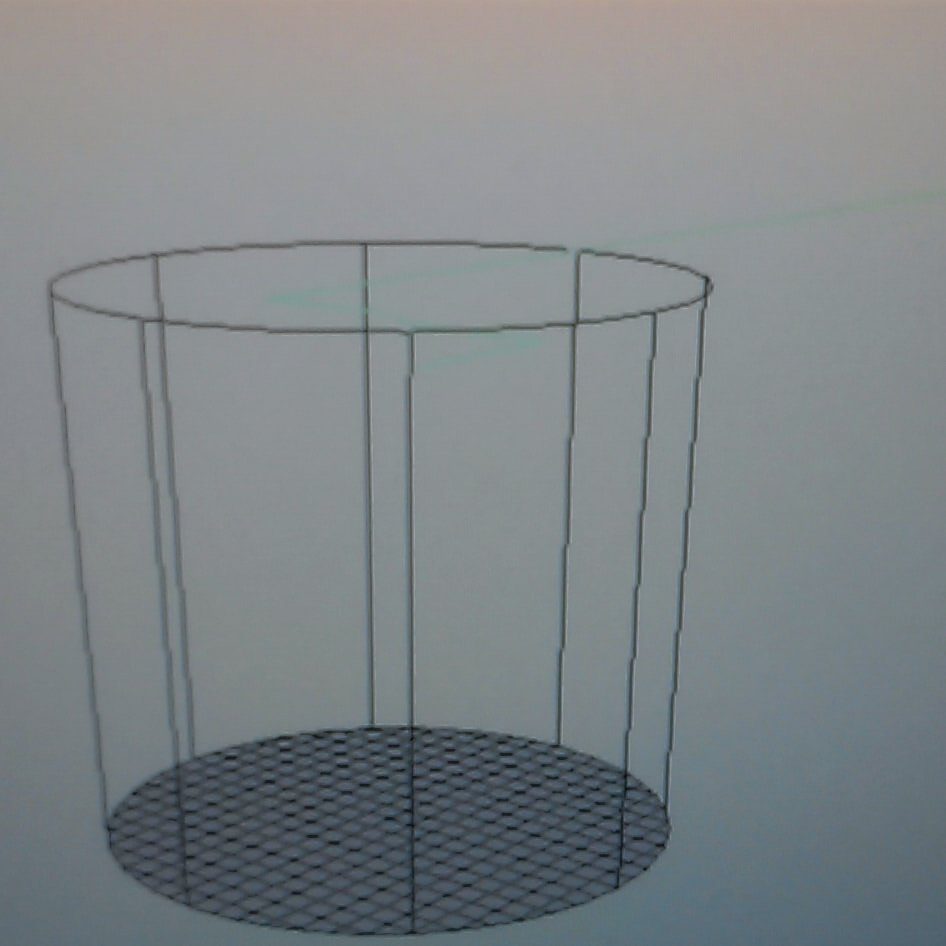

Thanx for the help, but it seems i am stuck at the same problem....
The three pictures attached are take after homing and loqered in manual control.
After the homing z axis.is at 193 and x and y axis are at 0.
I just noticed that when i manually run z axis it seems to go on the outside of the defined print bed in the repetier animation image....like it is moving horizontally:/
I am pretty new to arduino and 3d printers, but i am starting to believe that the motors are connected at the wrong place, even if i have followed the instructions thoroughly....or there might be some values in the firmware that makes the software believe that the axes are different.....i don't know:p
Any thoughts?:)
1. check the wires of motors and endstops, I think they might be wrong too;
2.re-install the firmware, change the settings according to the instructions and do not chang the other settings, and checkthe result.

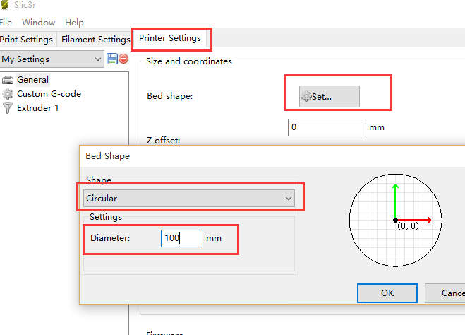

I have now successfully adjusted everything and think the printer works now......however, when i started a print after slicing, homing and autoleveling it printed about 10cm above the surface.
I did the changes according to the instructions (see attached pic) think its a little strange that the hotend stops at the end of the bed between z and x tower and not centered....could the changes here be the reason?
I also had problems extruding the abs filament and ended up melting a little plastic on the hotend at 245 Celsius while trying to manually extrude the filament. i just gently pushed the nozzle back in while cooling it down, and its back in position again. but i have ordered pla filament now, not only to avoid the high temperatures, but also to avoid the chemical smell from abs plastic:P

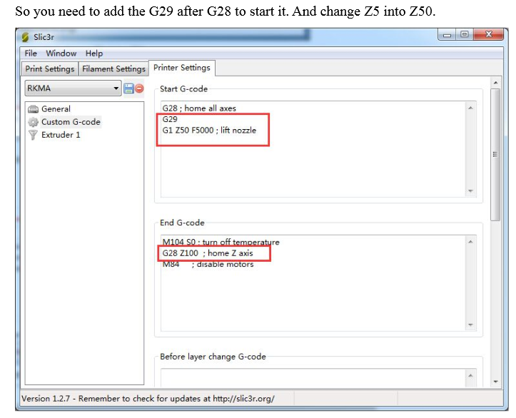

How about skip the G29 command, delete it and start print without it, sometimes it will cause the similiar problems, you can refer to the link here:
http://www.geeetech.com/forum/viewtopic ... 20&t=16825
Removed G29 command and finally got it printing......
I think i will change the hotend to alu so that i can print nylon as well....the original hotend on the delta rostock mini g2 can handle just about 240-245 Celsius on my machine....but i think for the most, i will be using PLA because of the smell.
This was very helpful for me, and i hope this thread can be helpful to others also:)
THANK YOU!!
