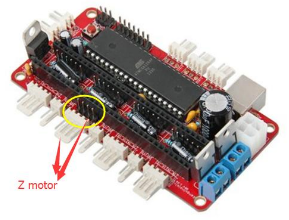

Hi, I can confirm this issue, I'm running in the very same problem...
Apparently, we are not alone
http://www.geeetech.com/forum/viewtopic ... 22&t=16942
http://www.geeetech.com/forum/viewtopic ... 22&t=16926
Where can we find the good instruction for the new FULL aluminum Prusa I3 ?
Sanguino headers are 90° so it collide X axis motor if you mount as instructed.

For those who's headers are 90°, you can mount it as this file shows:
mount the control board.zip
(559.12 KiB) Downloaded 536 times
And the latest PDF for this printer is here(please ignore the old pictures in it, just mount it on the left of your frame)
