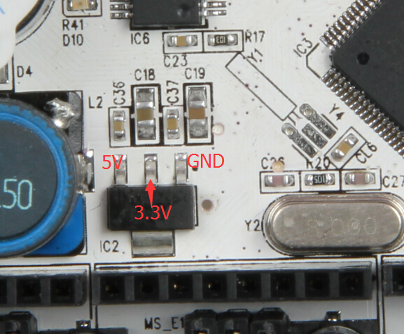

You can check the PSU output, it is 24V.
And the chip 1117 provides 3.3V, see the picture below:

Hi Mark,
Exact, I have only 1,4 volt and that is not enough to start the microcontroller.
I will try to find a AMS1117 3.3V and replace it if you agree.

Hi Mark,
Yes, 24 VDC and 5 VDC are correct.
On the pin 1 and 3 of the ams1117, 5VDC is there.

Seems to be the 1117's problem. You can change it and check the results.
