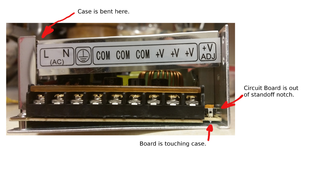

2. My power supply is damaged, see attached pic. The box it came in is in perfect shape so I can only assume it came from your supplier this way. It looks to be only mechanical and I think I can fix it but I don't want to void the warranty by opening the case. Please either send a replacement or give me assurance that if I try to fix it you will still honor the warranty if doesn't work.

And the PSU, you can try it first, seems it can still work. If it is defective indeed, you can contact the sales to replace it.

I also took the cover off of the power supply, cutting the warranty sticker, and by loosening the heat sink clamp was able to get the circuit board back in the correct position. I put everything back together and, when powered up later, it worked fine.
