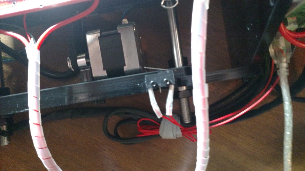

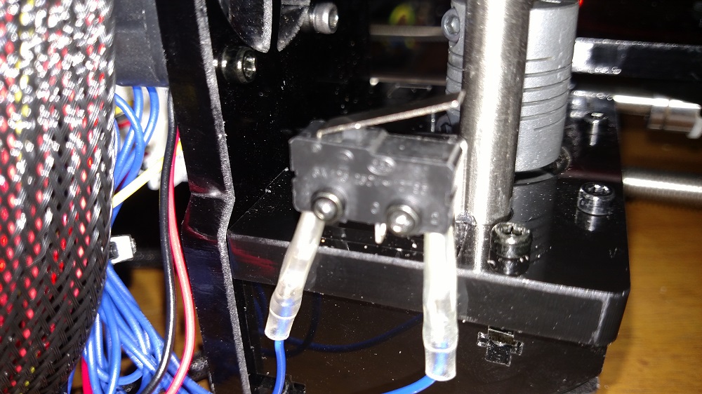

Post by jburke4 »
This is how my switches are wired. Not sure about your other question.

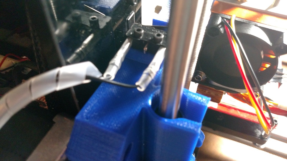

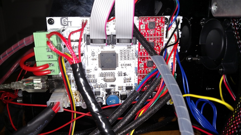

Post by jburke4 »
Better photo's.
