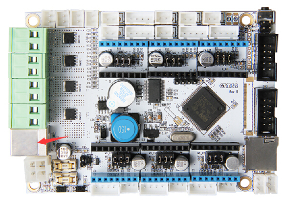

Note: If your GTM32 board is using the USB port like this one, then you need to install the firmware as follows. And if your board is REV A that has a micro USB port, then please come to this link:
http://www.geeetech.com/forum/viewtopic ... 20&t=17173

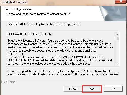

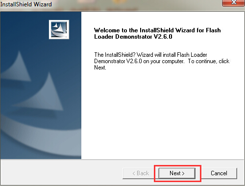

2) After downloading, please unzip the software and install it.
3) Unzip to get this file:

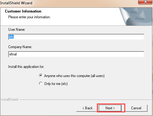

Double-click to do installation:

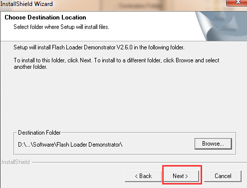

For the setting here, please follow its default:

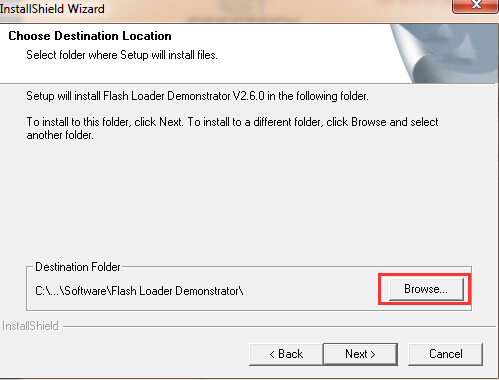

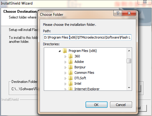

Here you can choose to install it in different destination folders. Here we select the D drive:

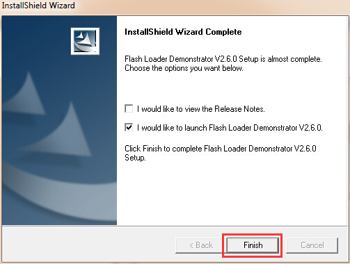

So far, the installation is completed.

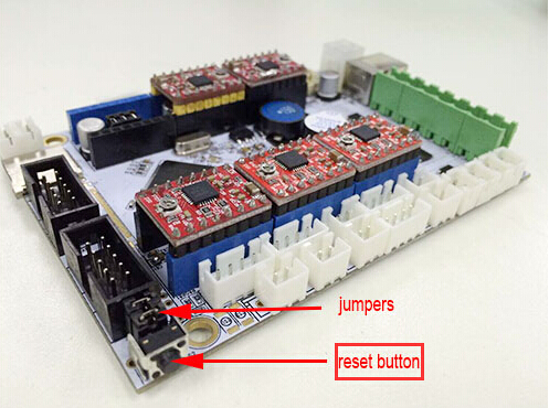

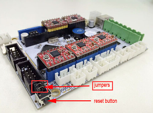

1) Before burning the firmware through USB connection, you need to insert 2 corresponding jumper caps on the control board.
2) Connect USB cable. After the successful connection with computer, you need to press the RESET button in the top right corner of the control board to reset.

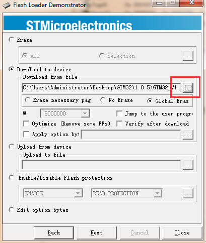

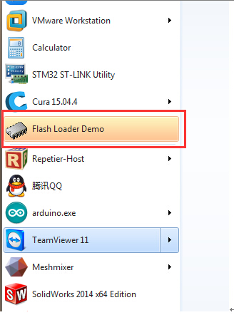

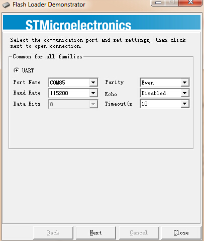

3) Open the Flash Loader Demonstrator:

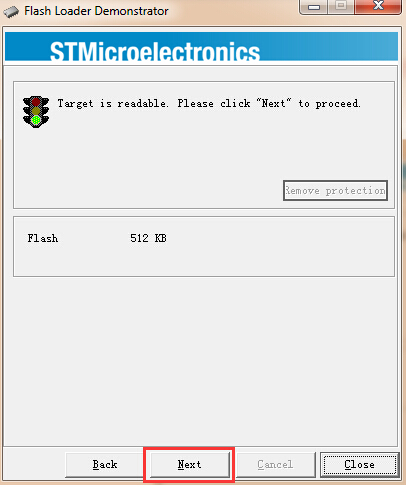

Confirm the COM port, for the rest please do the setting as default. Click the Next.

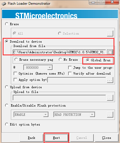

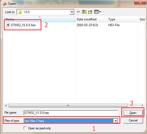

As shown in the following picture, choose the firmware you need to burn, and click Next to install it.

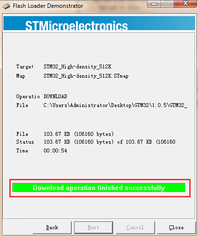

It means the burning is successful if you see the words of “download operation finished successfully!”, as shown in the following picture.
Attention: be sure to remove the jumper caps after installing the firmware.

what are the differences between Rev A and Rev B version of the GTM32 ?
I see at least : the USB connector, the CMS mosfets...
Mark
Posts: 1553
Re: Burning firmware through the USB port of GTM32 board
Post by Mark »
the two points you said are all the differences between this two boards, no other difference.
