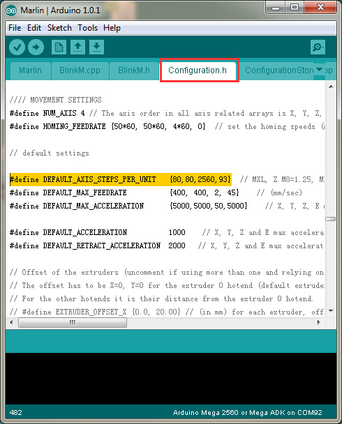

check the settings here:

// delta speeds must be the same on xyz
#define DEFAULT_AXIS_STEPS_PER_UNIT {78.74, 78.74, 2560, 95}
//#define DEFAULT_AXIS_STEPS_PER_UNIT {78.74, 78.74, 2560, 800}
this are the settings from the copy of firmware I have got from here ^
This is something I found here . http://www.printrbottalk.com/forum/view ... f=21&t=502
"Since the thread pitch of the Acme screws is different than the standard 5/16" threaded rod you will need to adjust your Z steps per mm calibration. The theoretical ideal value is 2015.748031496063. Enter that value into your firmware and recompile+upload, or use it in an M92 command as part of your Start GCODE."
So I guess I change the 2560 out for 2015.748031496063 . But It would be nice to be able to check that .
