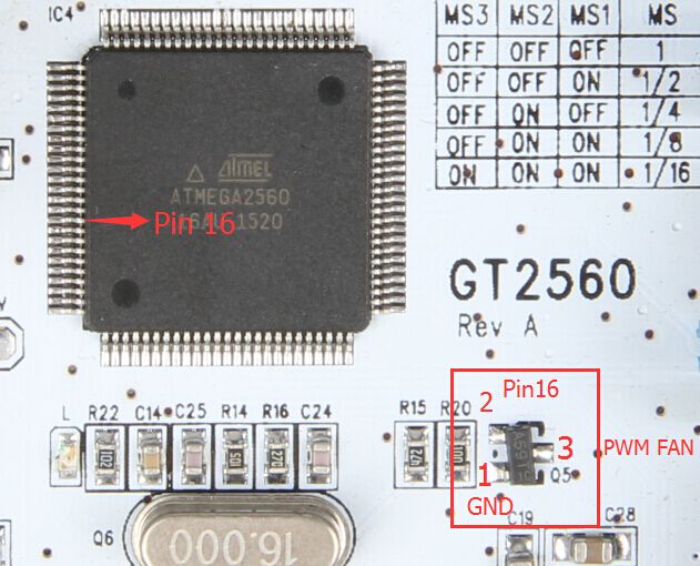

Silly me, I was looking for the pinouts from the GT2560 board.
Thanks
Mark
Posts: 1553
Re: PWM Fan Connector
Post by Mark »
The singal pin for the PWM fan is pin16, see the picture below:
