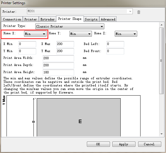

I just completed building the Pro B Prusa I3. The X-axis was moving in the wrong direction, so I changed that in the firmware (#define INVERT_X_DIR true). Now the extruder carriage moves left to the X-axis end stop when the Home command is given (using Repetier Host). However, once the X-axis is homed the directional keys in Repetier change color and become inactive (cannot move the extruder carriage to the right). The X value also reads 200 instead of 0 and the nozzle is about 20 mm off the heatbed (too far left). I am not sure which firmware setting needs to be changed, if any, or if a setting in Repetier Host is wrong.

Seems like you have set the home position to MAX not MIN:

Thanks. I discovered that after posting my question. X home still positions the extruder tip about 20 mm off the bed. This doesn't seem to make any difference when starting a print. Should I be using some sort of offset?

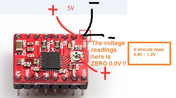

the output from the BOARD is not good!
So, How would you solve this problem?

what is the out put of the board? Driver board or GT2560?
driver voltage issue.jpg (59.31 KiB) Viewed 20701 times
As the picture indicates .. these are the voltage readings on my board!
The voltage is Zero!!
