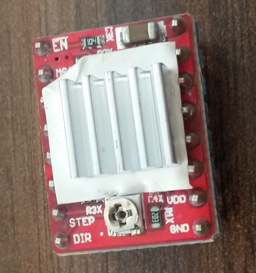

I guess you are right. I swapped this thing ( I guess it is called driver) from x axis, now extruder works, but x axis is not working now. Do you have any idea how to repair this driver? or I have to replace it only???

Re: Iprusa 3 x extruder motor doesn't work
Yes,you must replace it with another one,cuz every motor has its own corresponding driver module. Here is the purchase link:
