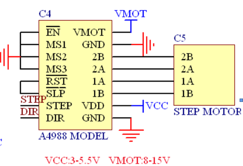

Hi,rohan
I'm sorry for not finding the Vref pin,here is the pin figure of the A4988 module:
