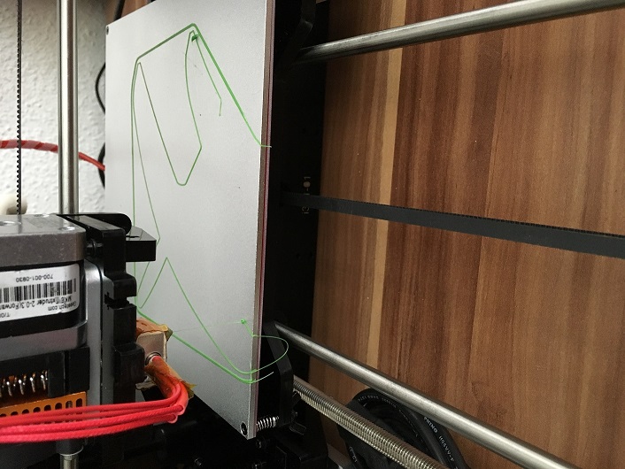

Hey Guys i hope you can help me to solve my problem with my prusa.
I try to print an Object. But the printer starts to print in front of the plate here was a Photo:
Foto 14.06.16, 15 42 35.jpg (138.93 KiB) Viewed 13909 times
If i homing all axes the Y-Axis drive off the plate and dont stop on the left Corner. I changed everthing in the Reptier Host but nothing works.
I dont know how to solve the problem :(
I hope you can help me here

i did it so like your post but it has no effect.

The First one. Am I right that when I homing all axes that the extruder must be on the left corner of the plate?
When I put 22 steps in the Y axis on the manual mode of the printer the extruder was on the right position. But how can I save this position??

But it doesn't work :/ I try diffrent settings. Someone have the firmware for me? My last chance is arduino :/

If i have to do here my changes to change homeposition?
// Travel limits after homing
#define X_MAX_POS 205
#define X_MIN_POS 0
#define Y_MAX_POS 235
#define Y_MIN_POS 0
#define Z_MAX_POS 190
#define Z_MIN_POS 0
I think Y-Max is false. That must be 205 to come over the plate. Am i right?

Yep,you can have a try.
