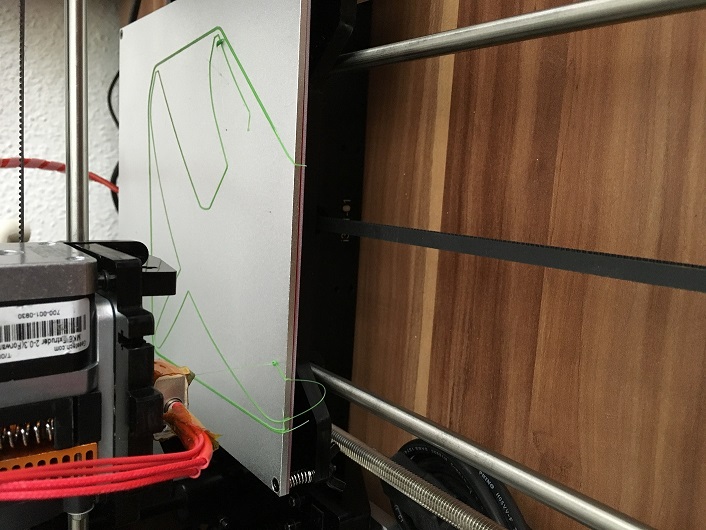

Hey Guys i hope you can help me to solve my problem with my prusa.
I try to print an Object. But the printer starts to print in front of the plate here was a Photo:
Foto 14.06.16, 15 42 35.jpg (138.93 KiB) Viewed 13906 times
If i homing all axes the Y-Axis drive off the plate and dont stop on the left Corner. I changed everthing in the Reptier Host but nothing works.
I dont know how to solve the problem :(
I hope you can help me here

CorpseGuard wrote:Hey Guys i hope you can help me to solve my problem with my prusa.

The First one. Am I right that when I homing all axes that the extruder must be on the left corner of the plate?
When I put 22 steps in the Y axis on the manual mode of the printer the extruder was on the right position. But how can I save this position??
