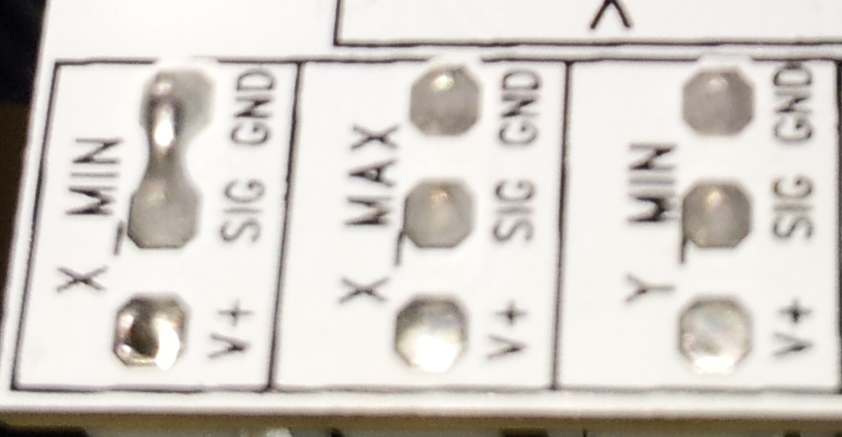

Geeetec please check your board!!! at the back of the board the signal and the gnd pole of x_min are solded Together....
- Senza nome1.jpg (166.38 KiB) Viewed 13148 times
Re: Geeetech prusa i3 pro x, problem endstop x axis
Hi,dr_house wrote:Geeetec please check your board!!! at the back of the board the signal and the gnd pole of x_min are solded Together....
So sorry for that.Did the X-axis endstop work after you solved the soldering problem?

Yes, work perfectly!!, thanks!!
