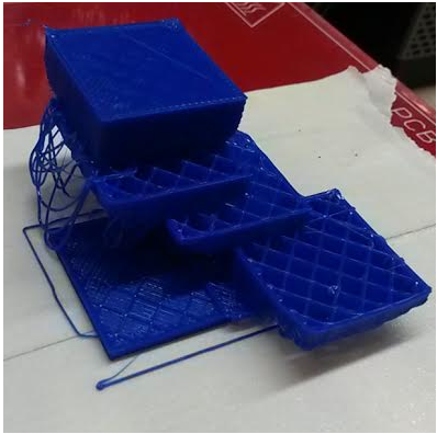

here is the problem I'm having:
cube 1.png (231 KiB) Viewed 25100 times

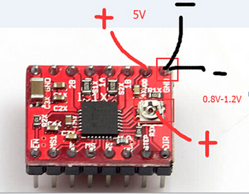

2.Test the voltage of driver module if you have a multimeter in your hand.I guess it's the insufficient driver voltage caused it...The normal voltage value is 0.8-1.2V,you can adjust the potentiometer to adjust the voltage:
3.If you have check all of the above,then re-upload the firmware to have a try.
