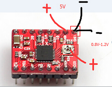

2.Test the voltage of driver module if you have a multimeter in your hand.I guess it's the insufficient driver voltage caused it...The normal voltage value is 0.8-1.2V,you can adjust the potentiometer to adjust the voltage:

okay so i purchased another gt2560 board and uploaded firmware per geeetech support's link so i know the FW is the right one and I'm still having trouble. I adjusted the pots on the drivers and no fix. To me this just leaves the steppers, could they be failing intermittently? Either the X or Y, because it's offsetting at random angles and distances it could be either right?
