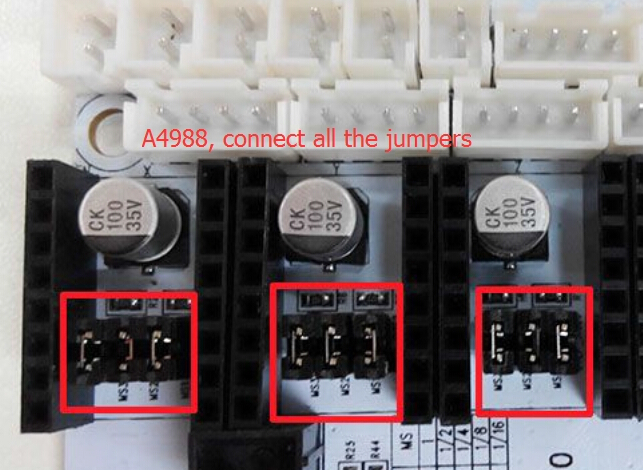

1.Were the jumpers all plugged into?
2.If all the jumpers are plugged into,and X motor still moves abnormally.You can modify the step/mm(80) paremeter to 20,which may work.
All jumpers are there. I wiggled them a little bit to check if the connections were solid, but that didn't change anything. I think it is the little red circuitboard that is not adjusted correctly for the X-axis.
I then adjusted the X-axis stepper rate (from 80 to 20) using the knob on the printer. That seems like an OK solution, but it takes a long time, and the setting is reset to the default value (80) when I turn the printer off and on again. How can this setting be saved permanently?
