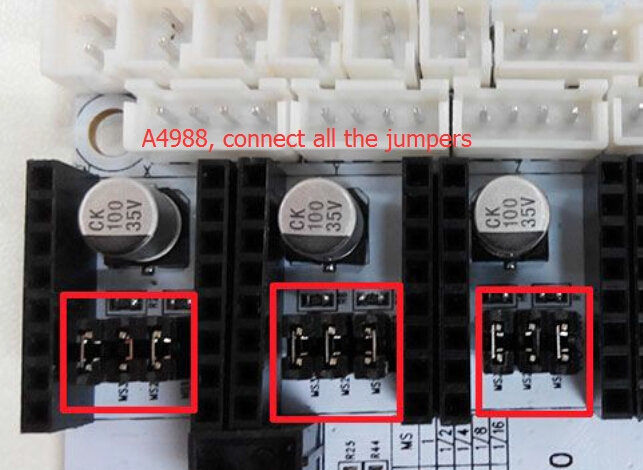

Maybe the wrong subdivision of Y motor cause it.
First,check if all the jumpers have been plugged in.
Then,if the first step is right already, and the Y motor still moves incorrectly,modify the "step/mm" parameter in LCD controller panel,following my steps:
"Control->Motion->Ysteps/mm:80", you need modify the value "80" to its double value"160".
Finally,remember to save the setting:"Control->Store Memory".
