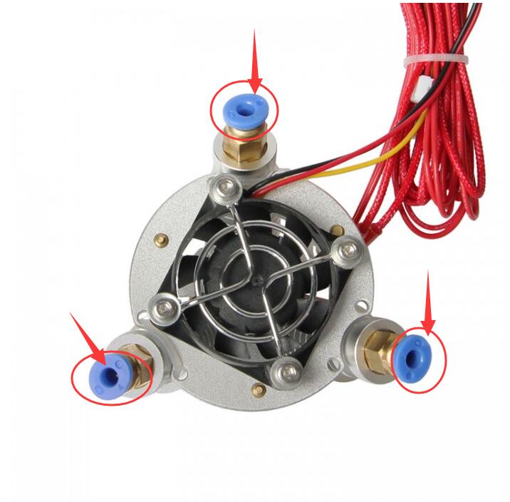

1.Unplug the three PTFE tubes from the metal tubes by pressing down the blue piece which is on the top of the metal tube. 2.Then heat up the hotend to the melting temp(depends on what filament you're using),plug hard the Ejector Pin into the three metal tubes for several times respectively,you'll see a lot of clogging coming out. 3.After the unclogging,plug the PTFE tubes to where it was.Remember to plug it into deep enough until it reaches the bottom of the metal and you can't insert it a little any more.I think everything will get better after you have done all of above.
