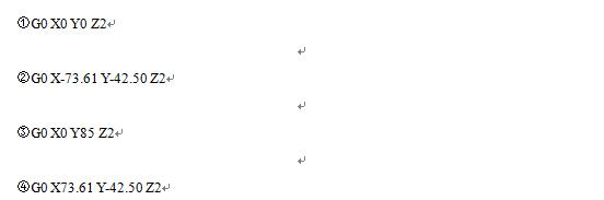

I managed to update but I need script setting. would you be able to help me with them. I thing there are 4 or 5 scripts.
thanks mate
Re: Rostock 301(GTM32 Pro)
AteeBull wrote:I managed to update but I need script setting. would you be able to help me with them. I thing there are 4 or 5 scripts.
thanks mate
Here it is:
