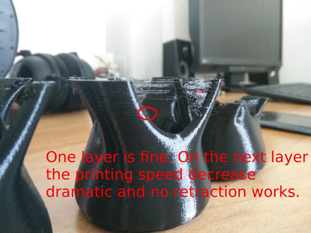

A few days ago I run into another problem. I started the first print jobs with more than 4 hours. From the first minute up to 4 or 4,5 hour everything was fine. But suddenly the printing speed decrease dramatically and the retraction also stops.
1. idea: In the first moment I was thinking the slicer crashed and I re-sliced the part and started the job again. It happened again. Please see the first video https://www.youtube.com/watch?v=n-iN1ZDObgA, direct after start, and compare it to the second video https://www.youtube.com/watch?v=QtqMdFofVg8, after approximately 4 hours.

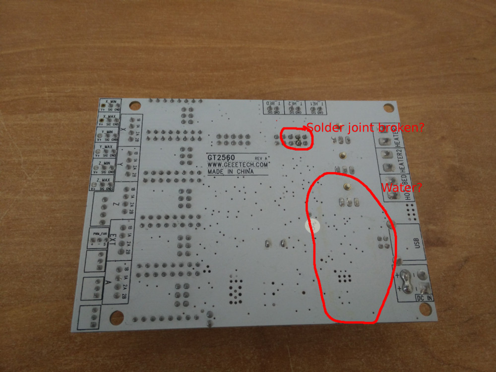

Last idea: The board broke? I can not test it... But I have reconstructed the board and had a closer look. Please see the attachments. Perhaps a water damage or some other defect is responsible for my problem. During construction I saw the marked points, especially the soldering joint, but I was thinking it is normal.

- Print quality before and after the 4 hour problem
- IMG-20160827-WA0003_new.jpg (188.51 KiB) Viewed 9604 times
- Water damage. Pins are green. Oxidation?
- IMG_20160827_103446_new.jpg (185.34 KiB) Viewed 9604 times
- Water damaged and soldering joint
- IMG_20160827_094840_new.jpg (160.98 KiB) Viewed 9604 times

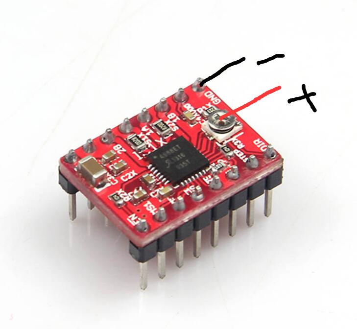

I think you can measure the voltage of extruder motor's driver A4988 when the speed you mentioned slowed down to see if the large fluctuation exists. You can try the following tips:

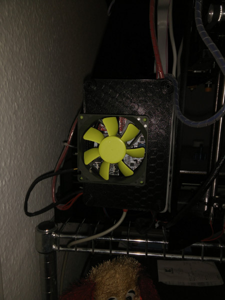

2: Look at the picture below. I'm using the http://www.thingiverse.com/thing:1307720, which was printed by a friend.

- Cooling
- IMG-20160821-WA0005_new.jpg (65.93 KiB) Viewed 9583 times
