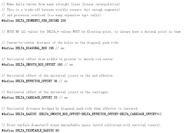

Where do I find definition / purpose of all the "Delta" settings ex; diagonal rods , smooth offset , effector offset, carriage offset, Delta radius,
Re: Delta M301 firmware ( Marlin )
divemasterbill wrote:Where do I find definition / purpose of all the "Delta" settings ex; diagonal rods , smooth offset , effector offset, carriage offset, Delta radius,
Here is the relevant settings in G2s's firmware,you can refer to it:
