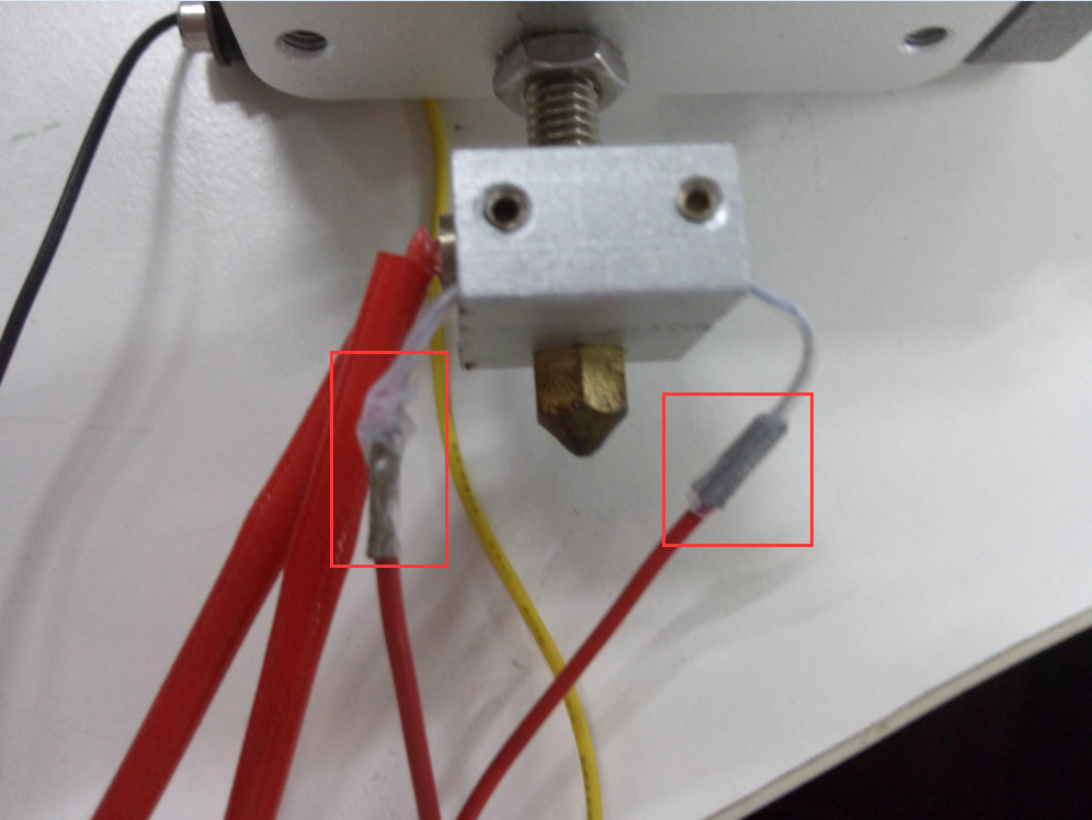

I shorted out my hot end and I bought a new complete extruder and now when I plug it up I get a min temp error

This means your thermistor is open circuit, please check this part, see if there's a poor contact
