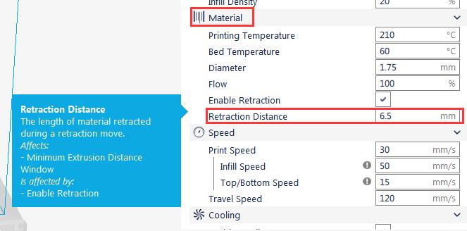

Sorry,i mistook the picture...
This is what i want to show you,you can find it in Cura(i'm using 2.1.3),you can decrease this value to see how it goes:

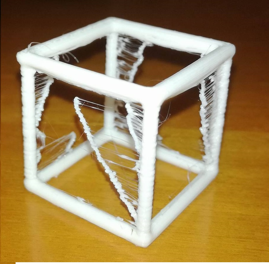

Made this using repetier with distance at 4mm and speed 40mm/s :(
will try with cura with higher distance

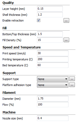

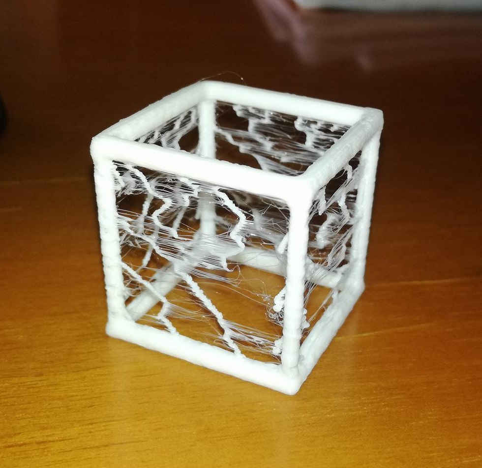

Again with Cura 15.04.6 speed 30mm/s and distance 6.5 mm. Better but not good enough...could the problem be the temperature 200° too high?

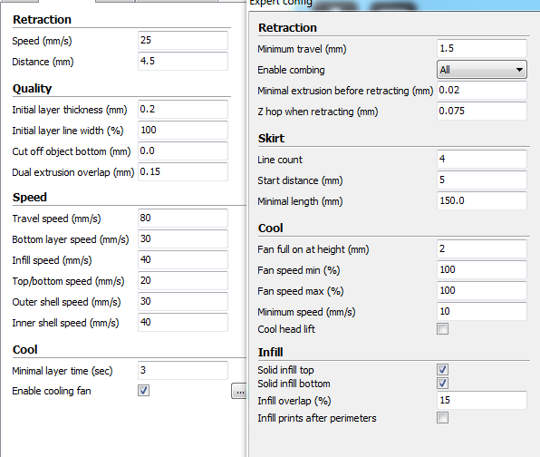

What model is your printer?Have you tried the recommended slicer settings we gave in Repetier Host?I think you can have a try.
BlastF
Posts: 23
Joined: Wed Aug 31, 2016 4:21 pm
Re: Problem with Retraction
Post by BlastF »
It's a Prusa i3 pro B, don't remember the recommended settings Xd 40mm/s and 4,5mm?
