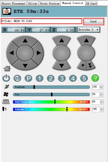

1)Send the commend "M280 P0 S160" to release the alarm in Repetier Host.

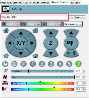

1)When the distance is too far(loose),we just need to increase the absolute value of the parameter,
for example,i increase it to -2.1 from -1.4 when the distance is not that far.We can send a G-code "M851" to check if we've modified the parameter successfully.
Before modifying:
After modifying:
2)Similarly,we decrease the value to -0.7 from -1.4 when it is too close.

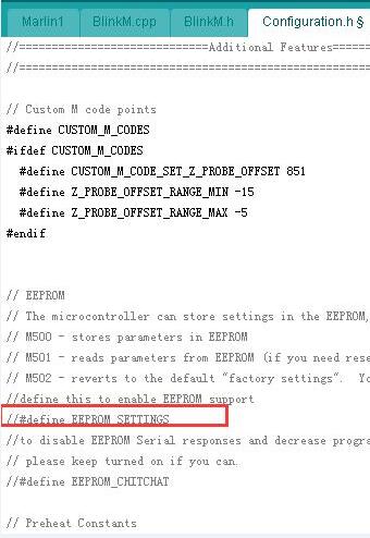

Some guys said they failed to modify the parameter,it does exist.
At this moment,you should comment(disable) the EEPROM function in the firmware:
Code: Select all
#define EEPROM_SETTINGS
After that,the modifying would work i guess.
