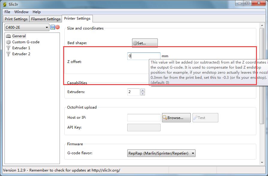

Is there anywhere in repetierhost or slic3r that an offset can be configured?
Re: Second print not at Z=0 new Prusa i3 M201
A video would be better,thx.
I'm not sure if this parameter helps:

I think this is fixed. Re-zero'd Z and tried -3 on the slic3r setting. If the current print job works I will try to remove the slic3r setting to see if its required or not.
