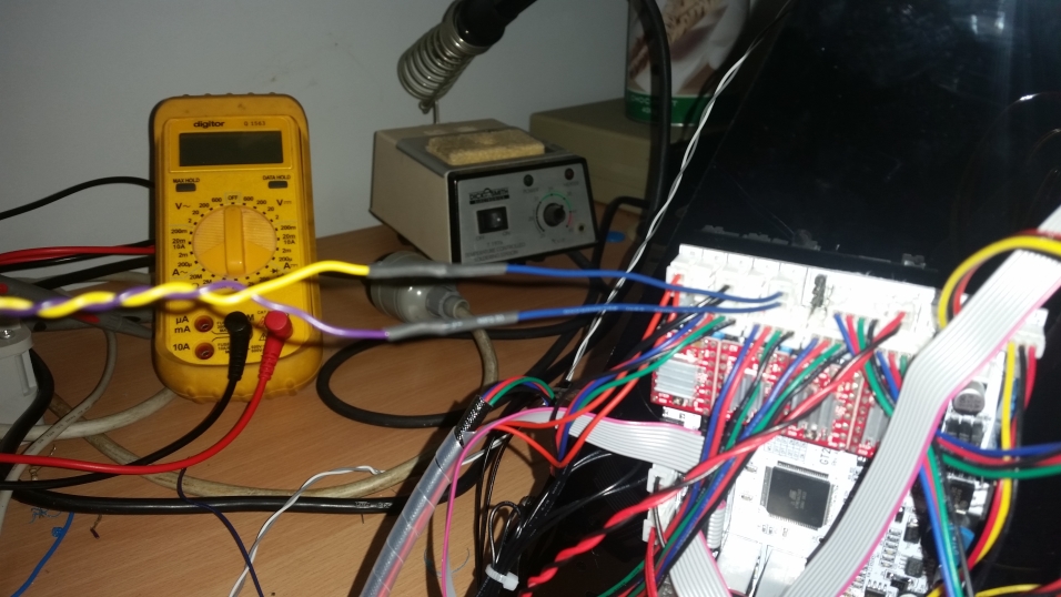

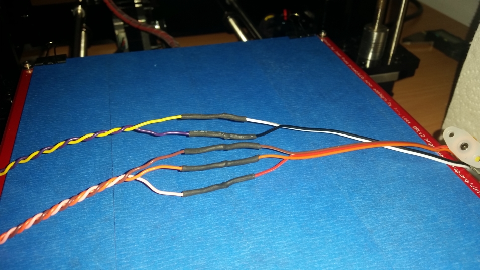

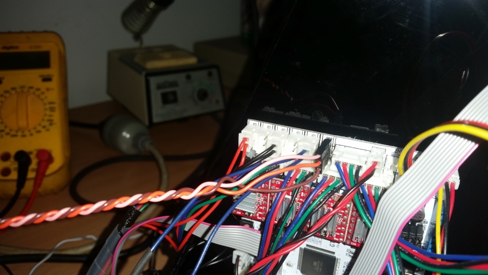

Hi William,
Yeah I've been trying to figure this out for about 2 weeks or so.
Connection are as below, I ended up soldering the connections when it first didn't work to rule out a dodgy connection in the pins and plug. I suspect their is something wrong with the driver board on the inside of the unit.
- Board connection 2.jpg (321.48 KiB) Viewed 23050 times
- Board Connection 1.jpg (342.66 KiB) Viewed 23050 times
- Sensor Connection.jpg (354.29 KiB) Viewed 23050 times
