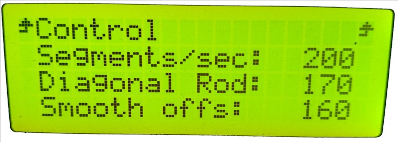

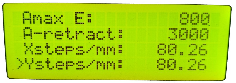

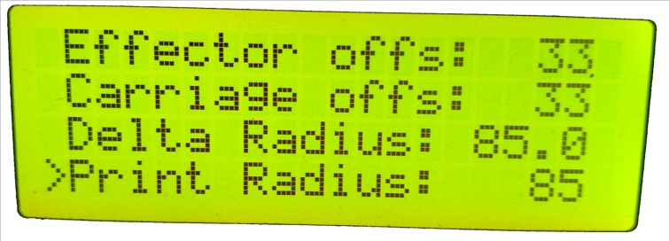

Hy,
I am Simon from Austria and i print normally with a bq Witbox 2,
but some weeks ago i bought a Rostock 301 on Aliexpress, because of the Mix Features,
but i have some Troubles with it and i don't know the right Settings and i would be glad for help!
I apologize in advance for my bad English ;-)
Questions:
1. How to set exactly the middle of the platform?
2. What do the abbreviations in the Settings mean?
-> Amax E? V.- jerk? Effector offs? Carriage Offs? Delta Radius) Print Radius?.... What would be the correct settings?
3. How many Esteps/mm? I use this Gearbox: http://www.omc-stepperonline.com/gear-r ... -p-40.html
Simon

Hy Cup,
OK i've done it!
But how about the other Questions?
Diagonal Rod is now 188, i've measured 200!?
Simon

Ma plaque chauffante d'impression en aluminium n'est pas plate, elle est concave, c'est la raison du « Delta Radius : 94.0 ».
Comme je débute avec les imprimantes 3D, je ne peux vous aidez pour les explications des différent paramètre, car je suis moi-même à la recherche des textes explicatifs, ma je ne trouve presque rien et Geeetech ne répond pas à nos demandes d'informations et des détails sur leurs produits !

My aluminum hotplate is not flat, it is concave, this is the reason for the "Delta Radius: 94.0".
As I start with the 3D printers, I can not help you with the explanations of the different settings, because I am looking for explanatory texts, but I can not find anything and Geeetech does not respond to our requests for information And details on their products!

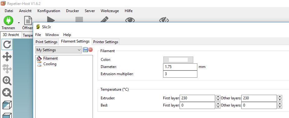

Hy Rene,
I tried to solve the Problem with the Extrusion Multiplier, i changed to 3,
because i dont know how many steps per mm.
I think it needs a better Motor with more torque for the axis too!
maybe this one: http://www.omc-stepperonline.com/3d-pri ... -p-17.html
Simon
