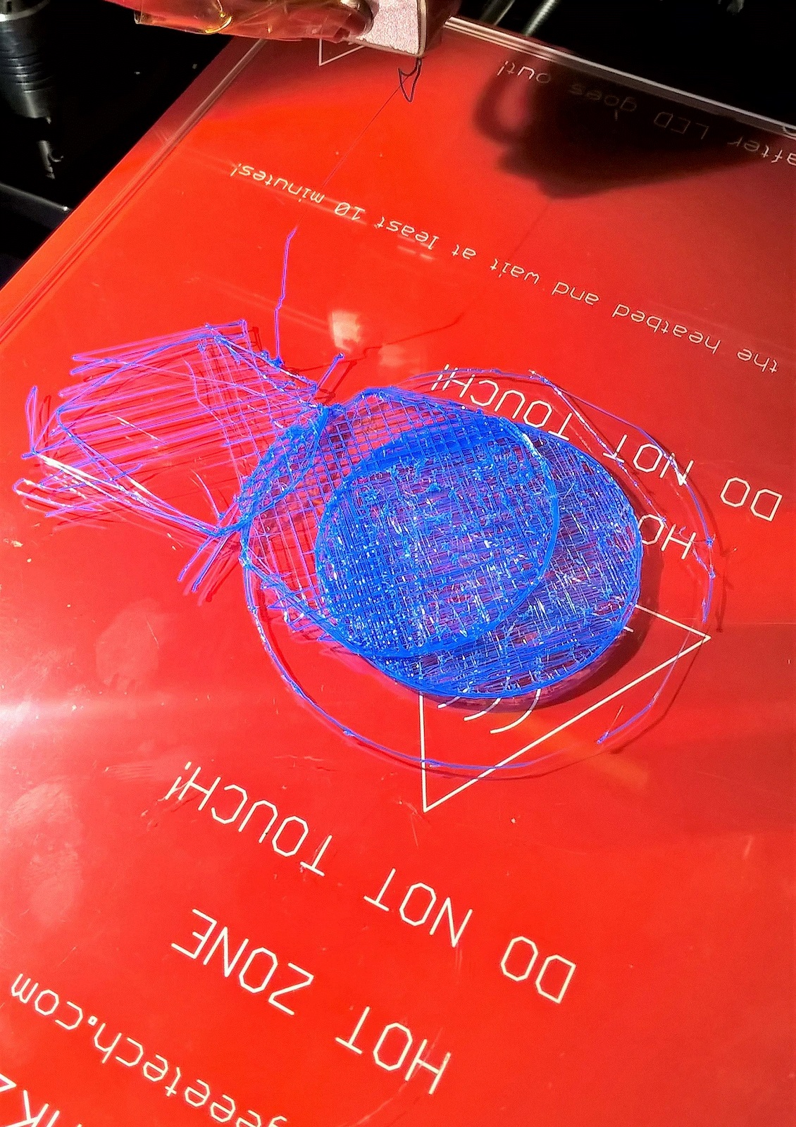

Re: DRIVER of Y STEPPER
Hi there,
I was investigating on the bad print quality. I've uploaded one picture. It is visible the first layer, in right position but with very poor quality (printed with the config file of GEETECH), the second layer shifted respect the first one (this is the effect of the lost steps and irregular moving of X axis due to the malfunctioning stepper, when the bad stepper was on Y axis the shifting was in Y direction), the third layer is even more shifted and with a very poor quality.
Observing the extruder working, I traced a little marker on the back side of the motor shaft to watch the rotation. The impression is that is not rotating regularly, some time is visible the retract effect, some time is rotating but even during the movements it stops long time. In my opinion this is the cause of the bad extrusion. During several movings there is not extrusion at all. But the temperature is ok, 205°, if I push manually the filament the extrusion is good and copious.
I decided to check the A4988 Voltage during the printing. The Y and Z axis that I know are working properly are showing a stable Voltage around 1V like I've set up. The X axis that now is moved by the bad stepper is showing a erratic and crazy Voltage, ever low, not stable Voltage, some time even at zero.
But the bad surprise is about the A4988 of the extruder. The Voltage is not stable at all, moving from 0,8V even up to 4,9V (the Voltage applied to all the stepper). So this stepper is not working like the 2 ones are working properly..........so I think I have two stepper malfunctioning, not only one.
50% of the stepper broken is not encouraging, it seems not a good performance for this kit........it's a pity because the assembly it was instructed good and kit well organized..
Waiting some answer about support on one A4988......now I will have to talk about two....!!!!
Regards
Maurizio
Regards
Maurizio
- DISK TEST PRINT.jpg (738.79 KiB) Viewed 12423 times
