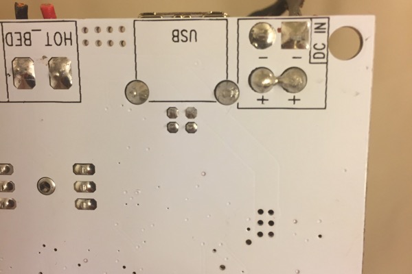

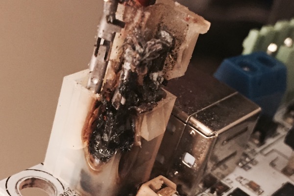

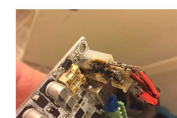

Wasn't to hard to figure out
- IMG_0609.JPG (60.33 KiB) Viewed 15350 times
- IMG_0607.JPG (57.04 KiB) Viewed 15350 times
- IMG_0610.JPG (69.97 KiB) Viewed 15350 times
- IMG_0608.JPG (42.97 KiB) Viewed 15350 times

This is my second board of this type that is a complete loss due to workmanship. Its a shame to its a really nice boardi have a couple that have been flawless for years on two other printers

OMG,so terrible it is.I guess the power cable and the board were broken?Anything else?
How did this happen?When printing?

I bought it from geeetech directly. And as I have stated 3 times it is obvious in the picture that there is s soldier bridge on the bottom of the main power pins on the board. This is from when the board was manufactured.
Re: Gt2560 in 3 in 1 box caught fire
Listen,as far as i know all the newer GT2560 boards have the soldier bridge on the back of them(intendedly),so i think the soldier bridge is not the main cause.
