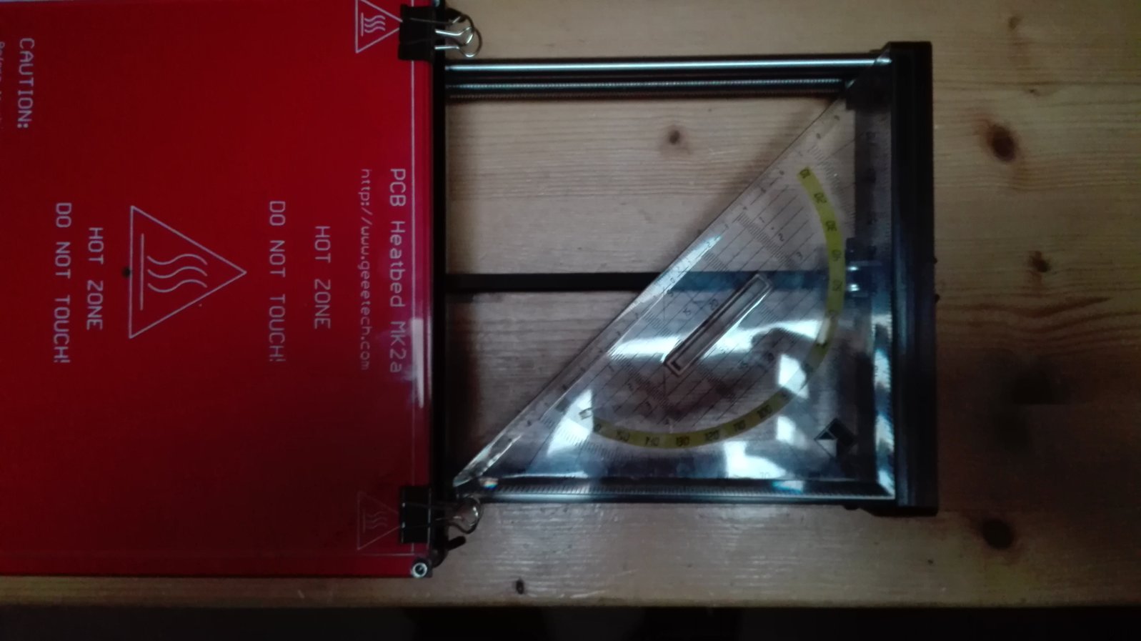

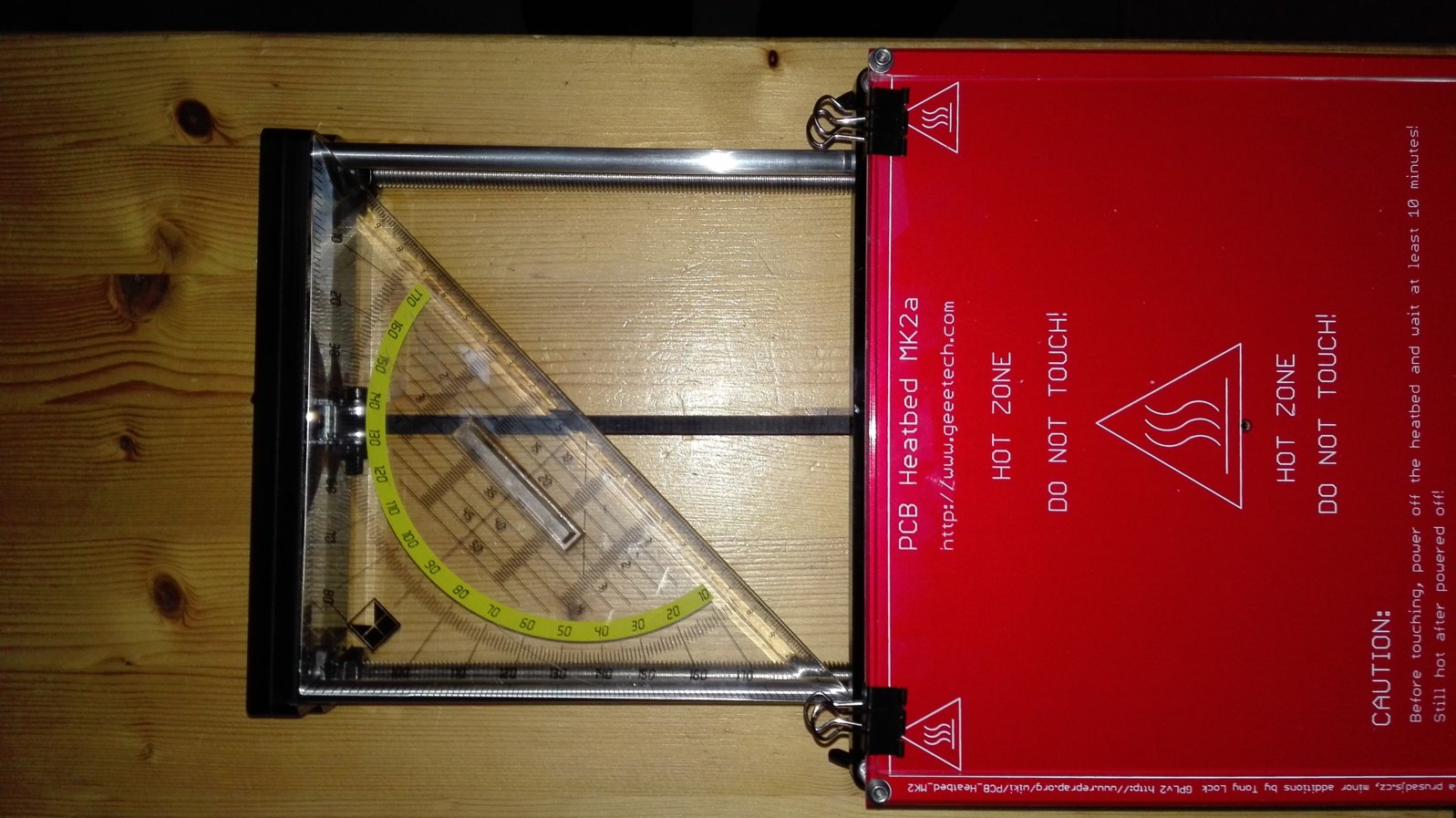

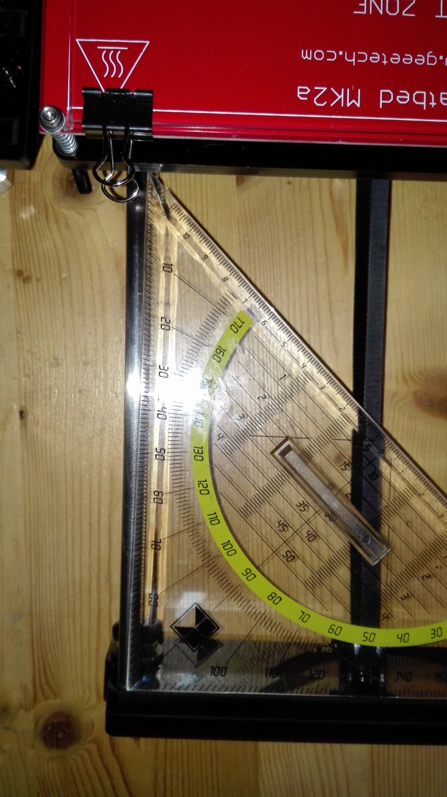

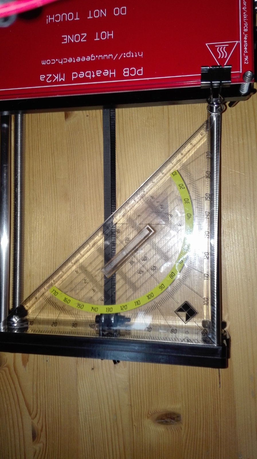

I made pictures with a protractor as reference.
Picture 01 and 02 are with the y-axis not attached to the rest of the frame.
Picture 03 and 04 are with a fully assembled printer.

It seems like the holes of one of these acrylic frames are not correctly drilled?
Did you find tha exact part?

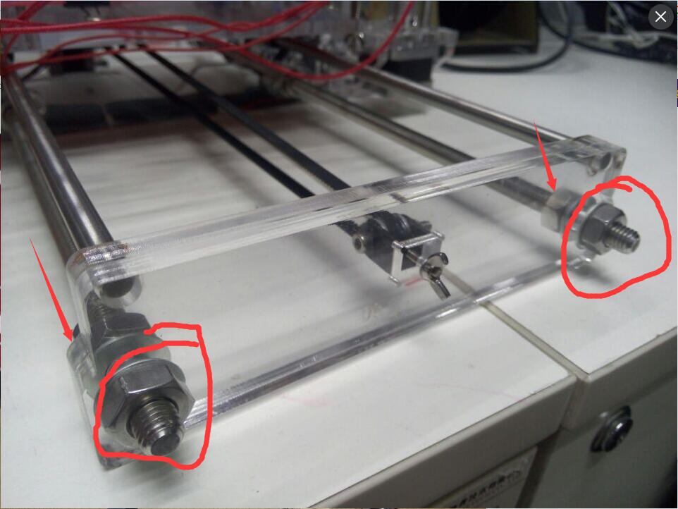

I think you can adjust the 4 screws to have a try,there might be something wrong with the installation if the rods are straight and the frames are good.
