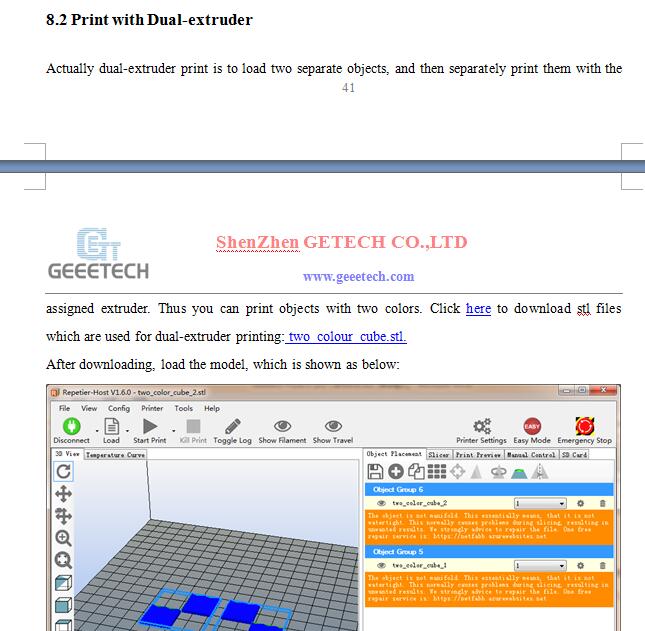

You can refer to this section in your ProC User Manual:

hi,
I tried as instructed but the two-color printing will not start.
That configuration should use on repieter to make it work?

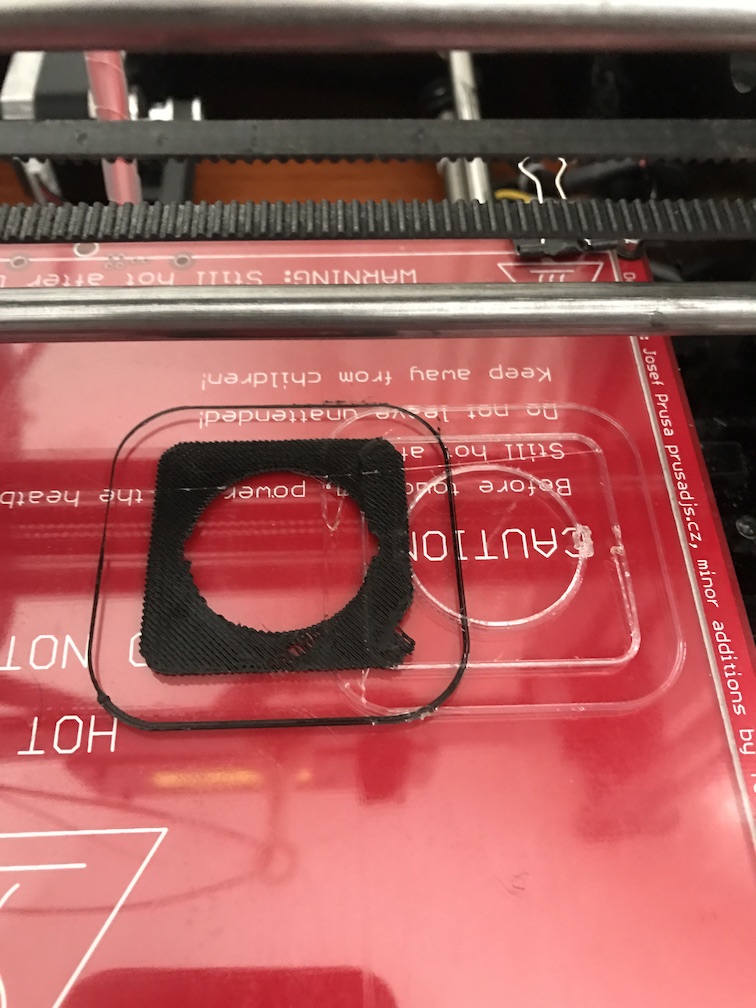

Why the press so?
It moves everything right and does not go downtown
Do not look at the quality I have to fine tune the dish.

You mean what?The white part?
What does the model look like?

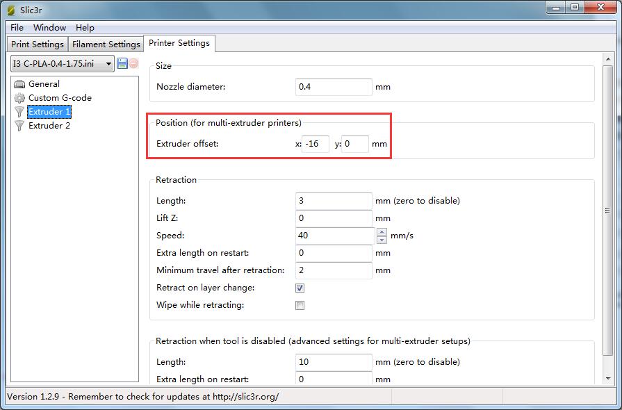

I guess you didn't configure the two settings in your slicer settings?
