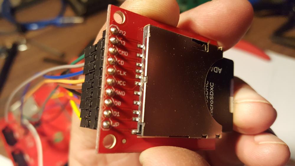

The crowning achievement however, was relocating the SD card socket to a slot on the front of the case's control panel. I originally bought one of the SD extenders on Amazon, and while it sort of worked at first (the card had to be inserted before turning the printer on, as it would not detect a newly inserted card), after a few weeks I started getting weird actions on the printer. Long story short, data from the card was being corrupted.
Apparently, I am the only one that wanted to relocate the SD socket, because there wasn't much useful information on the web. The cheap card extenders with the ribbon cables DON'T work, so don't waste your time and money. I wound up buying this breakout board: https://www.amazon.com/gp/product/B01MY ... e_o01_s00?
and direct-wiring it onto the original socket. Here are some pics: Note that the white wire turned out to be not needed, and I later swapped the red and brown wires so that the red wire is now the 3.3V VCC, and brown is now the D0. I'll also attach the color-coded sketch I drew to keep it all straight. After soldering, I applied a liberal coating of hot glue to protect the joints and keep wires from moving and shorting.
I don't get to these forums very often, so if you see this and need help or more details, PM me, as that will email me that I have a reply. Hope all this helps someone.....
