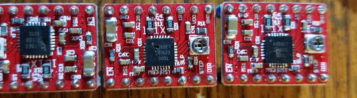

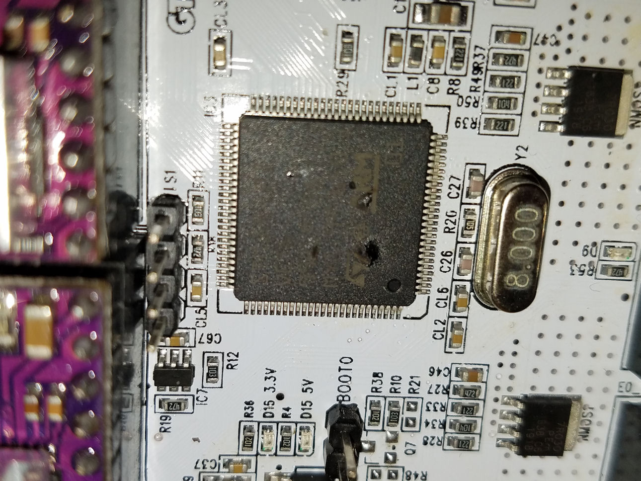

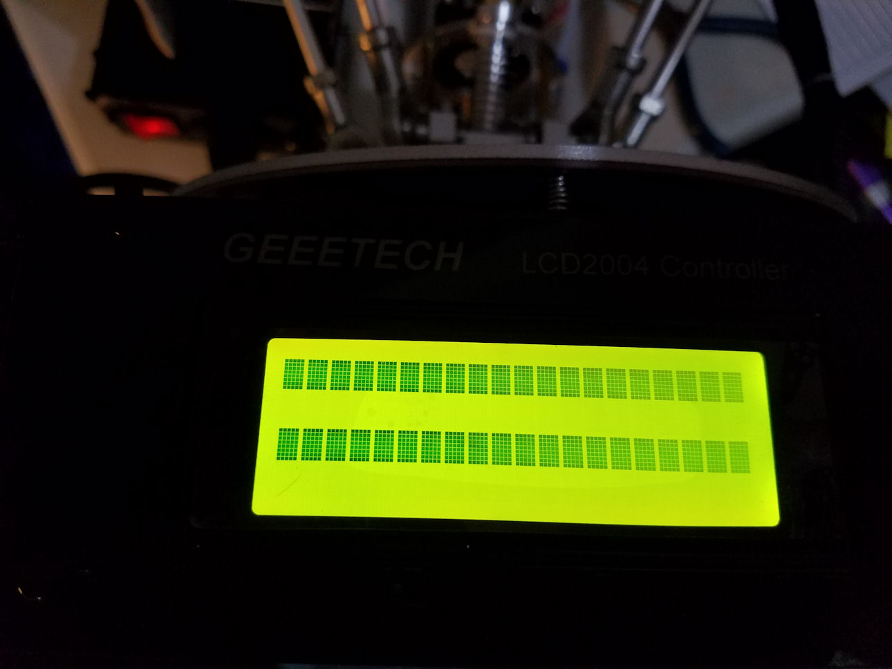

After I built kit and confirmed all wiring to board I figured everything was ready to go. The Drivers were already installed on board when I got the kit so I didn't have to fool with them. I thought that was nice. I the end I powered up the printer to find sparks flying from underneath the printer. Well come to find out the drivers that were installed backwards. So In the end lost most of the drivers and it blew out the boards CPU too. I have sent pictures to the one that sold me the printer and have not heard back yest on the resolution. I have searched for new board to use in the place of the one that went out but there is no place I can find that sells these boards. It either is too new or experimental. The Display is showing 2 bars of blocks across the entire screen. I'm assuming that this is due to the other issues. Where is the protection on this board to prevent these type issues from happening? I don't know which. Any ideas on where to get a new board or an alternate board to put in its place? I believe my wiring skills are still exceptional since I did work in an electronics company building them wonderful game systems that everyone loves like Pac-Man and may other stand-up games you played in places like Bars, Game Rooms, Walmart as you walked into the store. I'm not up on the micro chips much though.
DRIVERS THAT DECIDED IT WAS THE 4TH OF JULY EARLY.
Drivers That blew out sparks when powered up.jpg (130.6 KiB) Viewed 15653 times
THE MAIN BOARD CPU THAT DECIDED IT WOULD BE IDEAL TO BE THERE WITH THE DRIVERS.
main board cpu.jpg (273.03 KiB) Viewed 15653 times
LCD THAT HAS SQUARE BLOCKS 2 LINES ALL THE WAY ACROSS THE SCREEN
LCD BARS.jpg (112.89 KiB) Viewed 15653 times
