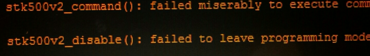

Nothing goes good!
Still all is bad
							Still all is bad
- 20170608_230802.png (425.22 KiB) Viewed 6270 times
