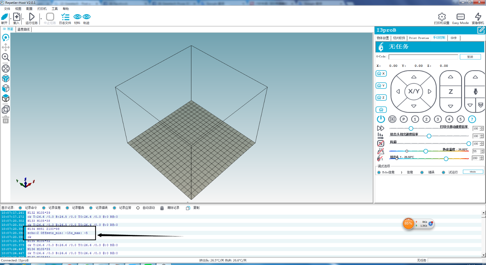

Re: Cant get 3Dtouch autoleveling sensor to work!
You should send code M851 Z100 first.The printer will return to Z Offset z_min value and Z Offset z_max value.If you set the value is not within this range, then there will be such an issue.
You can refer to it in here
- TIM图片20171110101740.png (356.29 KiB) Viewed 7674 times
