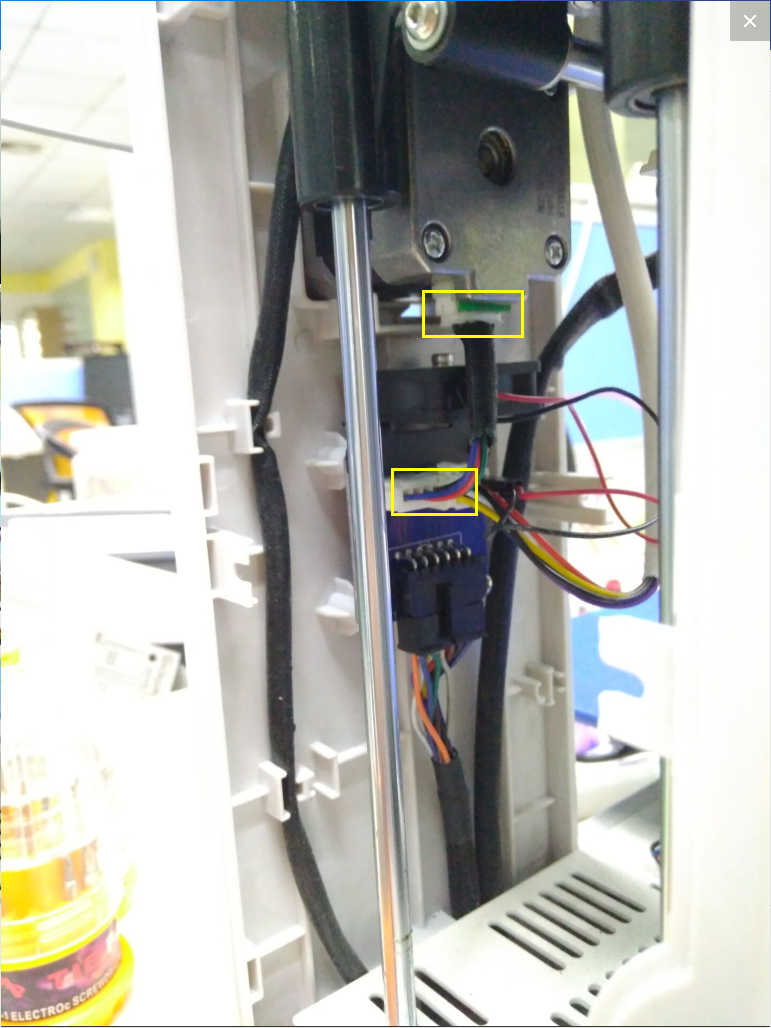

2.Check the wiring of extruder /Check the order of the motor cables line is the same
MOTOR LINE.png (953.33 KiB) Viewed 51451 times

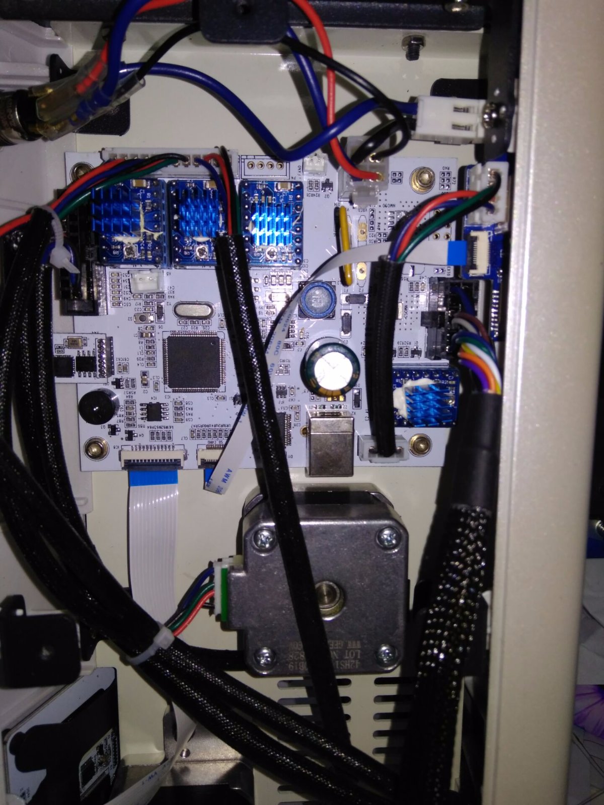

3.Increase the voltage of A4988(Blue type) up to 0.8-1.0V
(How to adjust it?You can refer to this post:
viewtopic.php?f=19&t=17097 )
4.Swap the A4988 of Extruder to other axes

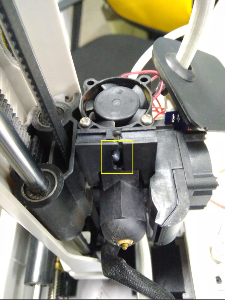

--------Nozzle installation tips --------
New version printer may be some differences with old version printer, but the installation steps are same
Update:The video of it shows you how to remove the broken nozzle off
https://youtu.be/d2_0J8U67vE

What means the Photos ?
can you MORE specific tell what theay means ? (e.g. E180-Swap.jpg) means that the A4988 must be changed with any other ?
Wich one you mean ? Swap the top with the right or ?
Please explaine if you want to help - thank you!
BTW: what does the nozzle in this case of extruder not working ?
Re: E180-Extruder not working
Inovatech wrote: Sat Mar 17, 2018 11:55 pm Hello!
Swap them then you can ensure the issue lead by the broken A4988 or not
