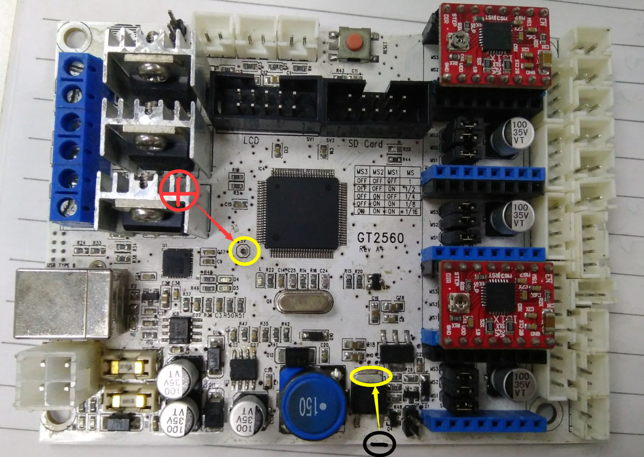

You should add 12V PSU and then test the voltage of here

I would look for a display PCB, voltage regulator.
Then I would check the tensions on his leads.
In = 12V DC
Out = 3.3V DC
William my friend, please confirm that I have correctly described the voltage values.
After these steps, you will know where to look for faults.

Sorry for add this info
Normal voltage of here is 5V(If you plug 12V PSU)
Normal voltage of here is 3.3V(If you plug 5v via USB cable)
